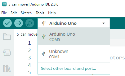

  7. In the Arduino IDE, select Arduino Uno as the board and choose the appropriate port for your device.
    ../_images/arduino_choose_board.png
