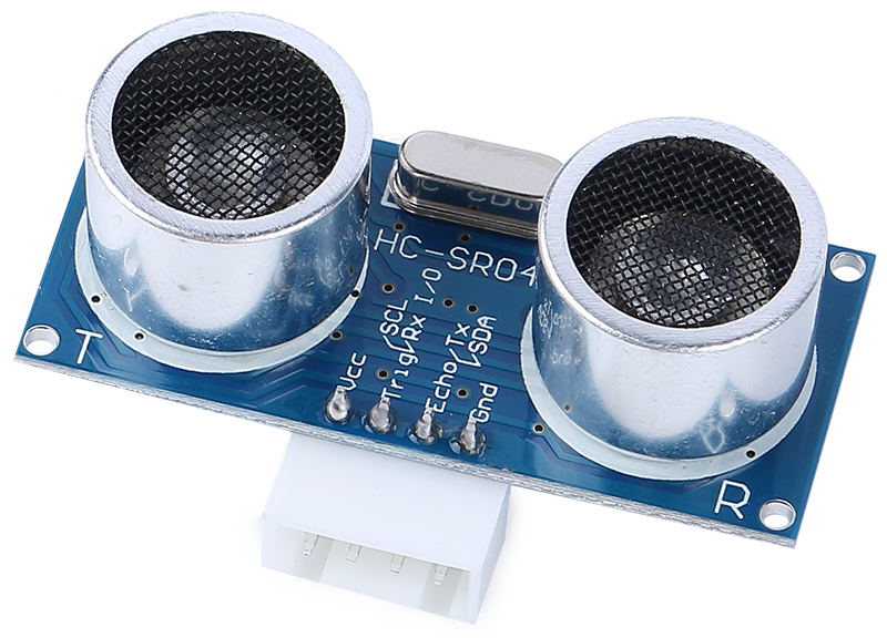

This is the HC-SR04 ultrasonic distance sensor, providing non-contact measurement from 2 cm to 400 cm with a range accuracy of up to 3 mm. Included on the module is an ultrasonic transmitter, a receiver and a control circuit.
You only need to connect 4 pins: VCC (power), Trig (trigger), Echo (receive) and GND (ground) to make it easy to use for your measurement projects.

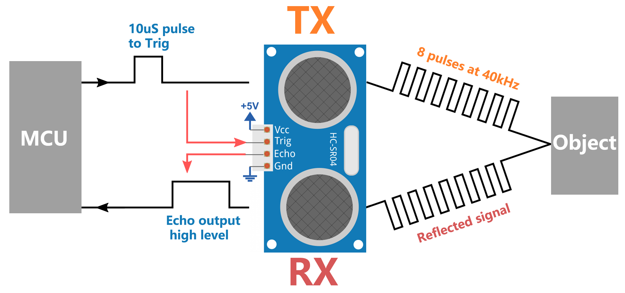

Principle
The basic principles are as follows:
  • Using IO trigger for at least 10us high level signal.
  • The module sends an 8 cycle burst of ultrasound at 40 kHz and detects whether a pulse signal is received.
  • Echo will output a high level if a signal is returned; the duration of the high level is the time from emission to return.
  • Distance = (high level time x velocity of sound (340M/S)) / 2
