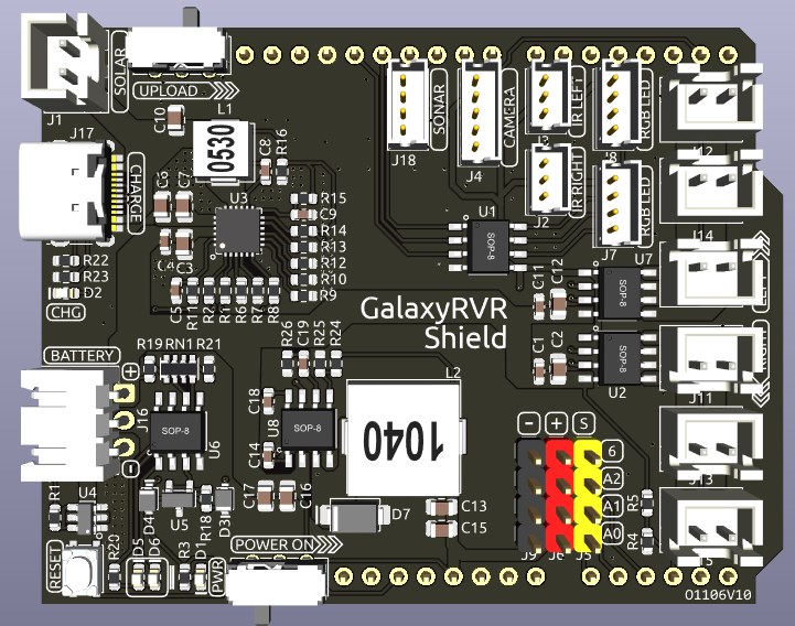

This is an all-in-one expansion board designed for Arduino by SunFounder, which contains various module ports such as motor, RGB strip, obstacle avoidance, grayscale, ESP32 CAM and ultrasonic module.
This expansion board also has a built-in charging circuit, which can charge the battery with PH2.0-3P interface, and the estimated charging time is 130 minutes.

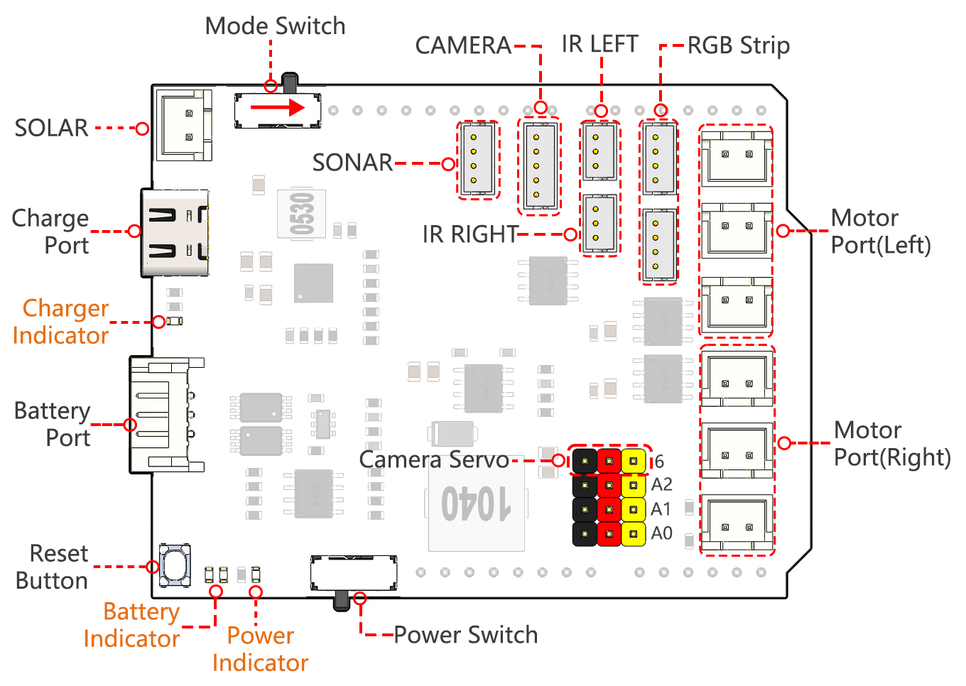

Pinout
../_images/galaxyrvr_shield_pinout.png
  • Charge Port
    • After plugging into the 5V/2A USB-C port, it can be used to charge the battery for 130min.
  • Battery Port:
    • 6.6V~8.4V PH2.0-3P power input.
    • Powering the GalaxyRVR Shield and Arduino board at the same time.
  • Reset Button
    • Press this button to reset the program on the Arduino board.
  • Indicators
    • Charge Indicator: Glows red when the shield is charging through the USB-C port.
    • Power Indicator: Glows green when the power switch is in the β€œON” position.
    • Battery Indicator: Two orange indicators represent different battery levels. They flash during charging and turn off when the battery needs charging.
  • Power Switch
    • Slide to ON to power on the GalaxyRVR.
  • Camera Servo
    • The servo on the camera is connected here.
    • The brown wire connects to β€œ-”, the red wire connects to β€œ+”, and the yellow wire connects to Pin 6.

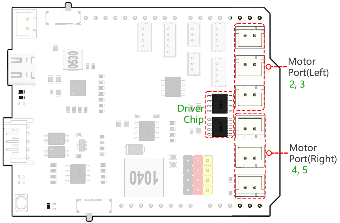

  • Motor Port
    • Motor Port(Right): 3 motors can be connected, but all 3 motors are controlled by the same set of signal pins 2 and 3.
    • Motor Port(Left): 3 motors can be connected, but all 3 motors are controlled by the same set of signal pins 4 and 5.
    • Port Type: XH2.54, 2P.

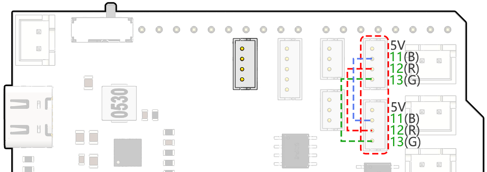

  • RGB Strip
    • For connecting 2 RGB LED Strips, the three pins of the strip are connected to 12, 13 and 11 respectively.
    • Port Type: ZH1.5, 4P.

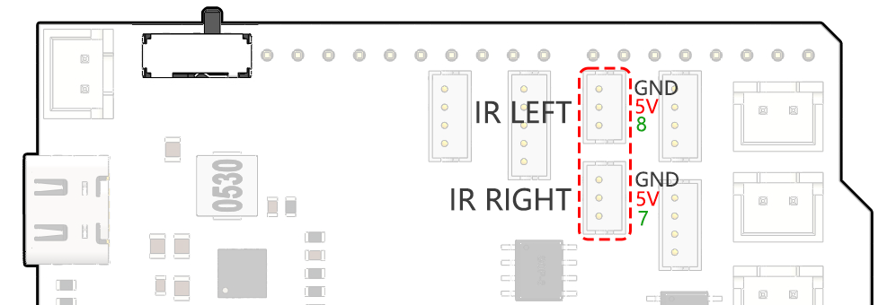

  • LEFT/RIGHT IR
    • Used for connecting two IR obstacle avoidance modules.
    • The left obstacle avoidance module is connected to pin 8, the right obstacle avoidance module is connected to pin 7.
    • Port Type: ZH1.5, 3P.

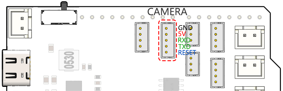

  • CAMERA
    • The Camera Adapter Board port.
    • Port Type: ZH1.5, 5P.
  • SONAR
    • To connect the ultrasonic module, both Trig & Echo pins are connected on pin 10 of the Arduino board.
  • Mode Switch
    • The ESP32-CAM and the Arduino board share the same RX (receive) and TX (transmit) pins.
    • So, when you’re uploading code, you’ll need to toggle this switch to the right side to disconnect the ESP32-CAM to avoid any conflicts or potential issues.
    • When you need to use the camera, toggle this switch to the left side so that the ESP32-CAM can communicate with the Arduino board.
  • SOLAR
    • This is the port for the solar panel, which can charge the battery when plugged into the solar panel.

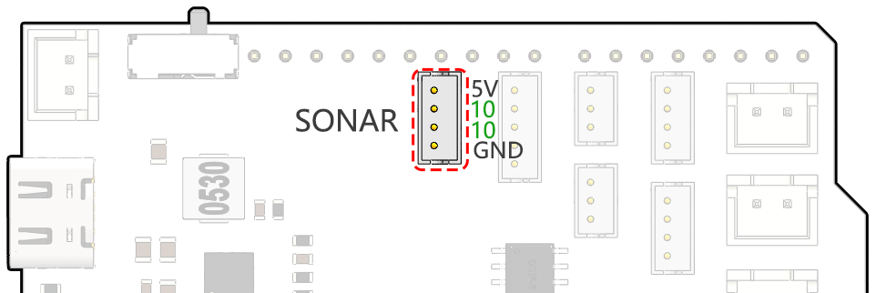

SONAR
This is the pinout for the ZH1.5-4P ultrasonic port, with the Trig & Echo pins connected to pin 10 of the Arduino board.

CAMERA
The camera adapter interface pin diagram is shown here, the type is ZH1.5-7P.
  • TX and RX are used for ESP32 CAM.
../_images/camera_shield.png
LEFT/RIGHT IR
These are the pins for the left and right obstacle avoidance modules.

RGB Strip
Below is the pinout diagram of the two RGB LED Strip, they are connected in parallel and the pinouts are the same.

Motor Port
Here is the pinout of the 2 sets of motor ports.
