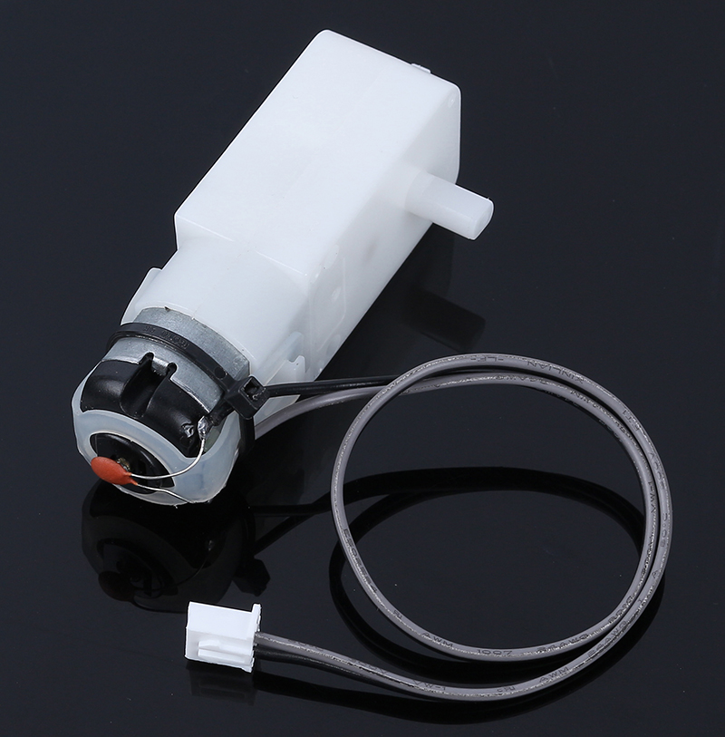

TT Motor
../_images/tt_motor_xh1.jpg
This is a TT DC gear motor with a gear ratio of 1:120. It comes with two 250mm wires with an XH2.54-2P connector. It can be powered with 3VDC.

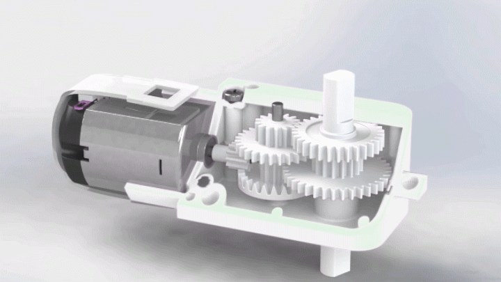

The TT Gear Motor is a specialized type of motor. It combines a standard motor with a series of gears, all housed within a durable plastic shell.
As the motor spins, the gears effectively transmit this rotational motion to the wheels of our rover. The integration of gears is pivotal, as it amplifies torque. This increased torque capacity enables the motor to maneuver larger and heavier loads, an essential capability in various applications.
../_images/motor_internal1.gif

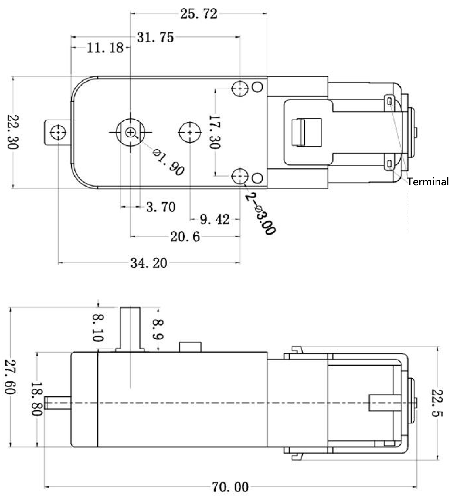

Dimensional Drawing
Unit: mm
../_images/motor_size.jpg
