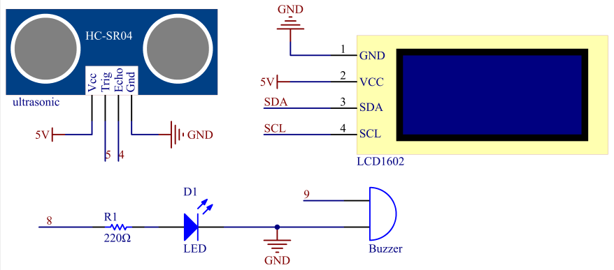

Schematic
../_images/image265.png

After the code is successfully uploaded, the current detected distance will be displayed on the LCD. Then the buzzer will change the sounding frequency according to different distances.
If the code and wiring are fine, but the LCD still does not display content, you can turn the potentiometer on the back.
