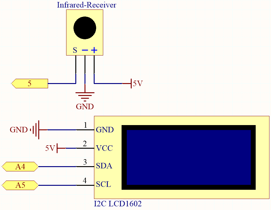

Schematic
../_images/circuit_guess_number.png
Wiring
In this example, the wiring of LCD1602 and infrared receiving module is as follows.

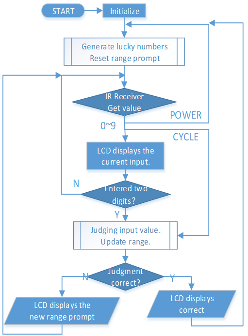

In order to make the number guessing game become vivid and funny, we need to achieve the following functions:
  1. The lucky number will be displayed when we start and reset the game, and the number range prompt is reset to 0 ~ 99.
  2. LCD will display the number being input and the number range prompt.
  3. After inputting two digits, there appears result judgment automatically.
  4. If you input a single digit, you can press the CYCLE key (the key at the center of the Controller) to start the result judgment.
  5. If the answer is not guessed, the new number range prompt will be displayed (if the lucky number is 51 and you enter 50, the number range prompt will change to 50~99).
  6. The game is automatically reset after the lucky number is guessed, so that the player can play a new round.
  7. The game can be reset by directly pressing the POWER button (the button in the upper left corner).
In conclusion, the work flow of the project is shown in the flow chart.
