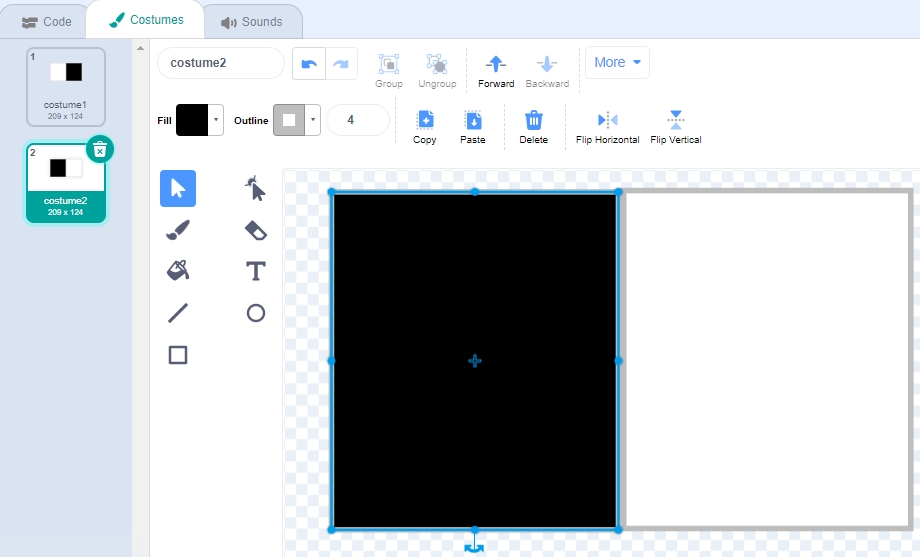

  • Select one of the rectangles and choose a fill color of black.
    ../_images/tile_paint_tile4.png
  • Now select both rectangles and move them so that their center points match the center of the canvas.
    ../_images/tile_paint_tile5.png
  • Duplicate costume1, alternating the fill colors of the two rectangles. For example, the fill color of costume1 is white on the left and black on the right, and the fill color of costume2 is black on the left and white on the right.
    ../_images/tile_paint_tile6.png

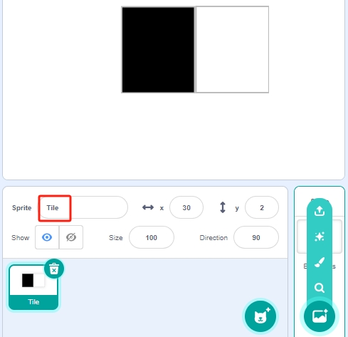

  • Return to the Code page and set the sprite’s name to Tile.

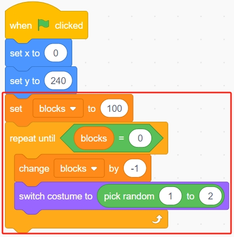

  • Create a variable - blocks and give it an initial value to determine the number of times the Tile sprite will appear. Use the [repeat until] block to make the variable blocks gradually decrease until blocks is 0. During this time, have the sprite Tile randomly switch its costume. After clicking on the green flag, you will see the Tile sprite on the stage quickly switch costumes.
    ../_images/tile_script_tile2.png

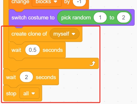

  • Create clones of the Tile sprite while the variable blocks is decreasing, and stop the script from running when blocks is 0. Two [wait () seconds] blocks are used here, the first to limit the interval between Tile’s clones and the second is to let the variable blocks decrease to 0 without stopping the program immediately, giving the last tile sprite enough time to move.
    ../_images/tile_script_tile3.png

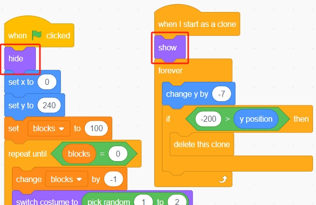

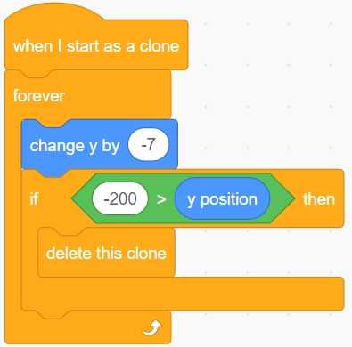

  • Now script the clone of the Tile sprite to move down slowly and delete it when it reaches the bottom of the stage. The change in the y coordinate affects the drop speed, the larger the value, the faster the drop speed.
    ../_images/tile_script_tile4.png
  • Hide the body and show the clone.
    ../_images/tile_script_tile5.png

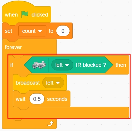

In the backdrop, read the values of the 2 IR modules and make the corresponding actions.
  • When the green flag is clicked, set the variable count to 0.
    ../_images/tile_script_backdrop.png
  • If the left IR obstacle avoidance module senses your hand, broadcast a message - left.

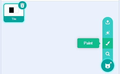

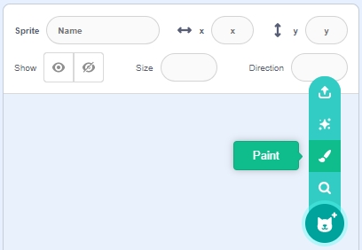

  • Again, tap on the Add Sprite icon and select Paint.

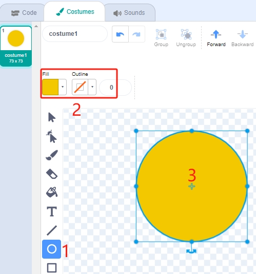

  • Go to the Costumes page, select the fill color (any color out of black and white) and draw a circle.
    ../_images/tile_paint_ir2.png

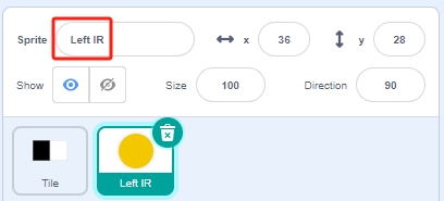

  • Return to the Code page and change the sprite’s name to Left IR.

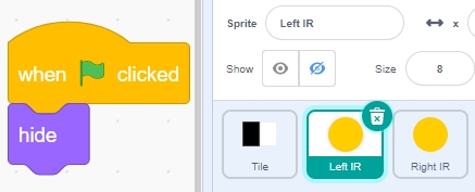

  • Now start scripting the Left IR sprite. When the green flag is clicked, first hide the sprite.

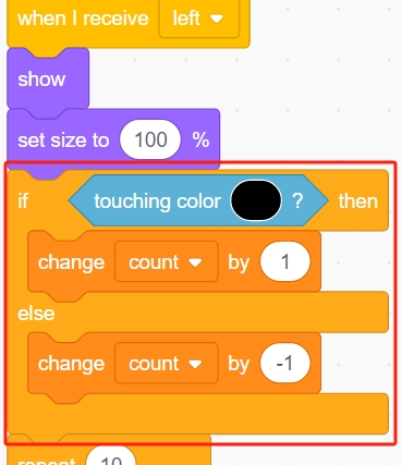

  • Then determine if the black block of the Tile sprite is touched, and if it is, let the variable count increase by 1, otherwise decrease by 1.
    ../_images/tile_script_ir3.png

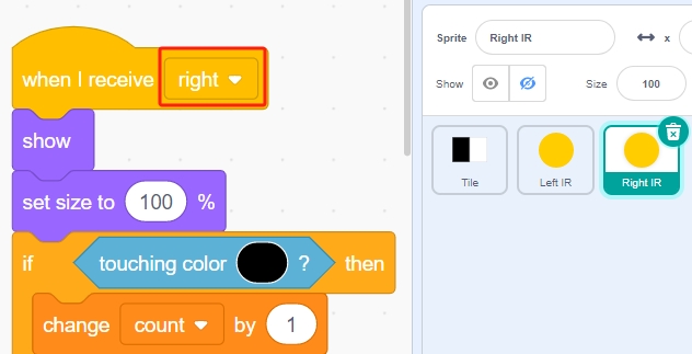

6. Right IR sprite
The function of Right IR sprite is basically the same as Left IR, except that it receives Right information.

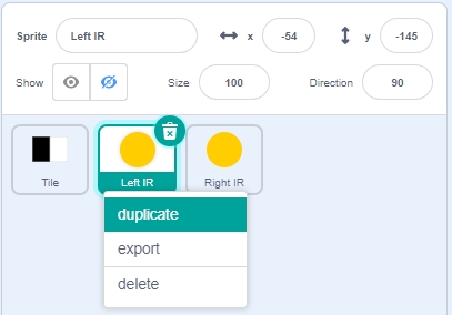

  • Now duplicate the Left IR sprite and change the sprite’s name to Right IR.
    ../_images/tile_paint_ir4.png
  • Then change the received message to - right.
    ../_images/tile_script_ir5.png

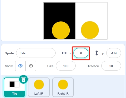

7. Running the Script
  • Now adjust the positions and sizes of the three sprites.
    • Drag the Tile sprite to the bottom of the stage and set its x position to 0.
    • Move the Left IR sprite into the left frame. You need to go to the Costumes page to reduce the sprite’s size to only 50% of the frame’s size.
    • Similarly, move the Right IR sprite into the right frame. You need to go to the Costumes page to reduce the sprite’s size to only 50% of the frame’s size.
    • Make sure that the Left IR and Right IR sprites are above the Tile sprite.
    ../_images/tile_paint_ir5.png
  • Now all the scripting is done, and you can click on the green flag to run the script.
