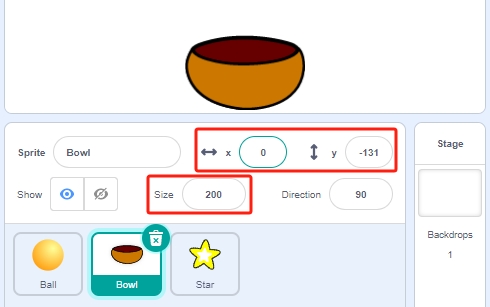

  • Position the Bowl sprite at the center bottom of the stage and increase its size.
    ../_images/ball_set_bowl.png

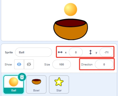

  • Place the Ball sprite directly above the Bowl sprite, setting its direction to 0 to allow vertical movement.
    ../_images/ball_set_ball.png

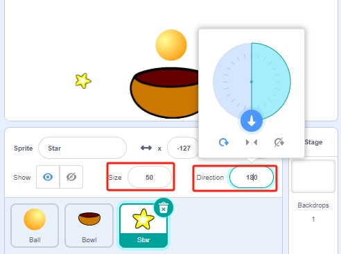

  • Adjust the Star sprite’s size and set its direction to 180 to ensure it falls downward. This can be altered to different angles if preferred.
    ../_images/ball_set_star.png

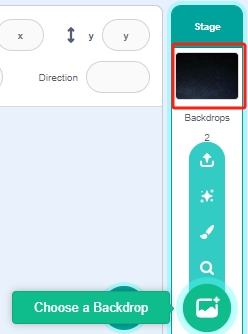

  • Add the Stars backdrop for added ambiance.
    ../_images/ball_select_backdrop.png

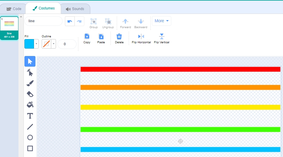

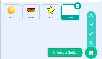

2. Draw a Line Sprite
  • Now add a Line sprite.
    ../_images/ball_select_line.png

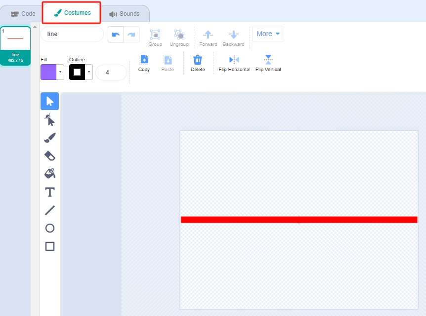

  • Navigate to the Costumes page of the Line sprite.
    ../_images/ball_open_cos.png

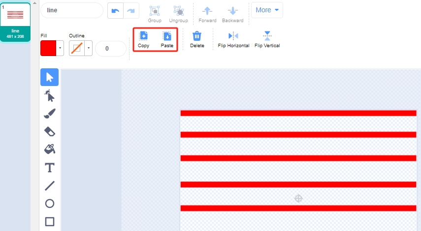

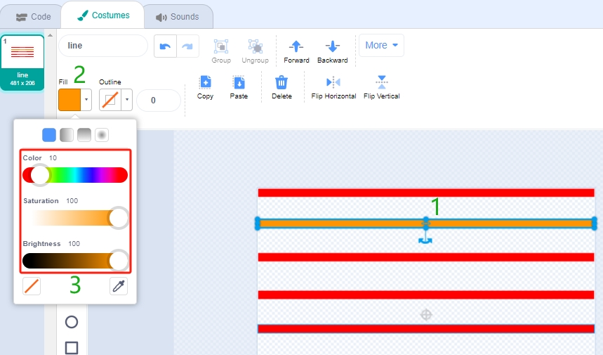

  • Slightly reduce the width of the red line on the canvas, duplicate it four times, and align these lines.
    ../_images/ball_copy_line.png
  • Color each line differently. Select a line, use the Fill tool, and pick a color.
    ../_images/ball_set_bk_color.png
  • Apply this method to color all lines accordingly.
    ../_images/ball_select_line_color.png

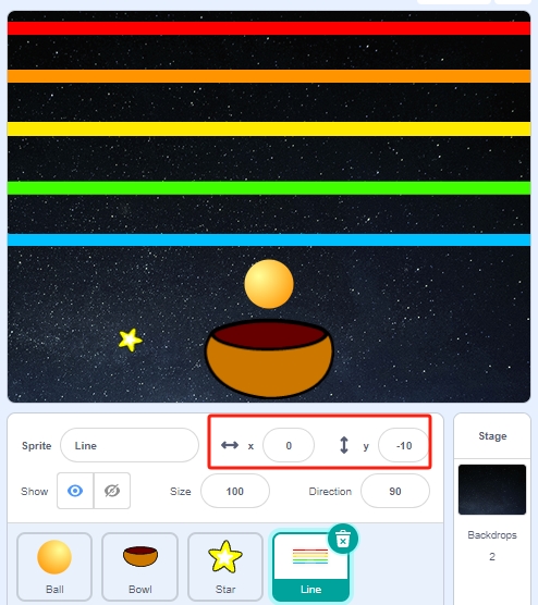

  • Return to the Code page and position the Line sprite at the top of the stage.
    ../_images/ball_line_position.png

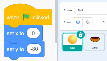

  • When the green flag is clicked, set the initial position of the Ball sprite.
    ../_images/ball_script_ball1.png

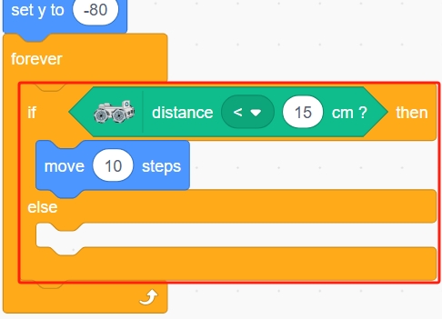

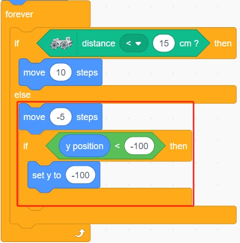

  • Use an [if else] block to check if the distance is less than 15. If true, move the Ball sprite up by 10 steps, given its direction is set to 0.
    ../_images/ball_script_ball3.png
  • Otherwise, let the Ball sprite fall, limiting its Y coordinate to a minimum of -100, adjustable to appear as though it’s landing on the Bowl sprite.
    ../_images/ball_script_ball4.png

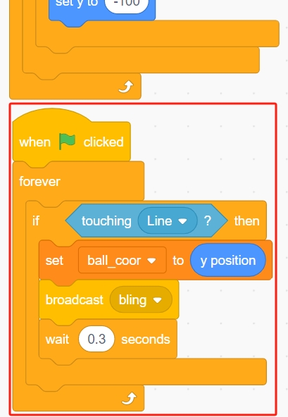

  • Script interaction where the Ball sprite, upon touching the Line sprite, records its Y position to the variable ball_coor and broadcasts a bling message.
    ../_images/ball_script_ball5.png

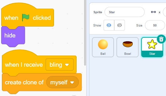

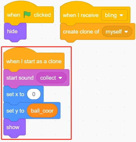

  • Initially hide the Star sprite when the green flag is clicked. Upon receiving the Bling message, clone the Star sprite.
    ../_images/ball_script_star1.png
  • Set the clone’s position and sound effects to synchronize with the Ball sprite’s position.

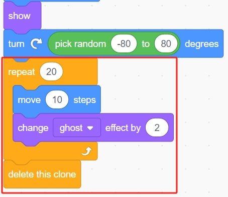

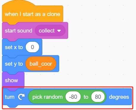

  • Allow it to rotate between -80 to 80 degrees randomly.
    ../_images/ball_script_star3.png
  • Adjust the appearance and behavior of the Star sprite as needed to enhance the visual effect.
