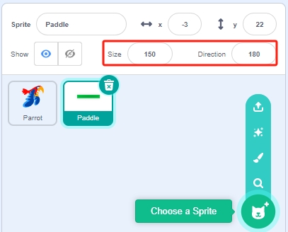

  • Add the Paddle sprite, set its size to 150%, rotate it to 180 degrees, and position it in the top right corner.
    ../_images/parrot_choose_paddle.png

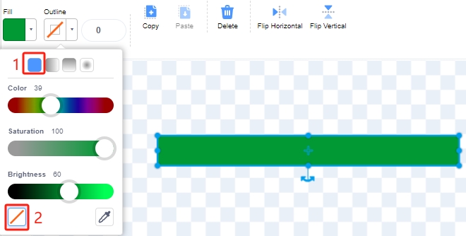

  • Navigate to the Costumes page of the Paddle sprite, select the Paddle on the canvas, and then click the Outline tool.
    ../_images/parrot_set_parrot1.png
  • Change the outline effect to full fill mode and use the removal tool to eliminate it.
    ../_images/parrot_set_parrot2.png
