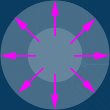

Move in All Directions(K)
The Zeus Car will move in the appropriate direction when you swipe the app_move_k widget.
../_images/joystick_move.png
The car moves once every time you slide, so if you don’t release your hand all the time, the car keeps moving.
../_images/zeus_move.jpg
