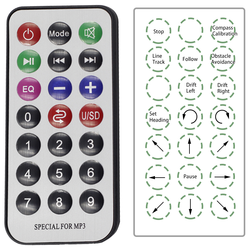

Press the different keys on the remote control to control the car.
Stop: Stop all movements of the car.
Compass Calibration: Turn on compass calibration.
Line Track: Switching to line track mode.
Follow: Switching to follow mode.
Obstacle Avoidance: Switch to obstacle avoidance mode.
Drift Left/Right: Drift to the left/right.
Set Heading: After placing the car in one direction with your hand, click on this key to make this direction as the front of the car movement. This allows you to quickly specify a direction instead of slowly rotating the car to that direction with other keys.
Rotate Left/Right(Cycle/USD Key): Turn left/right
Move in All Directions(1 ~ 9): Control the car to move in all directions.
Pause: The function is basically the same as Stop, but if the head of the car is not facing the direction originally set, it will slowly move to the set direction.
Use the number keys 1~9 to make the Zeus Car move in 8 directions.
The car will turn 45° left with the body as the center if you press
once. Depending on the previous state, it will move forward or stop. If the previous state is stop, it will stop after 45° left turn; if it is forward, it will move forward after the left turn.
Similarly, pressing
once will make the car turn 45° to the right, and then it will move forward or stop depending on the previous state.
