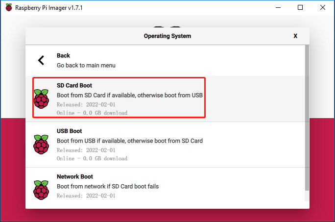

  6. Select a boot-mode, SD card boot is recommended.
    ../_images/ssd4.png

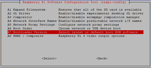

  3. Select Advanced Options -> Bootloader Version
    ../_images/ssd12.png
