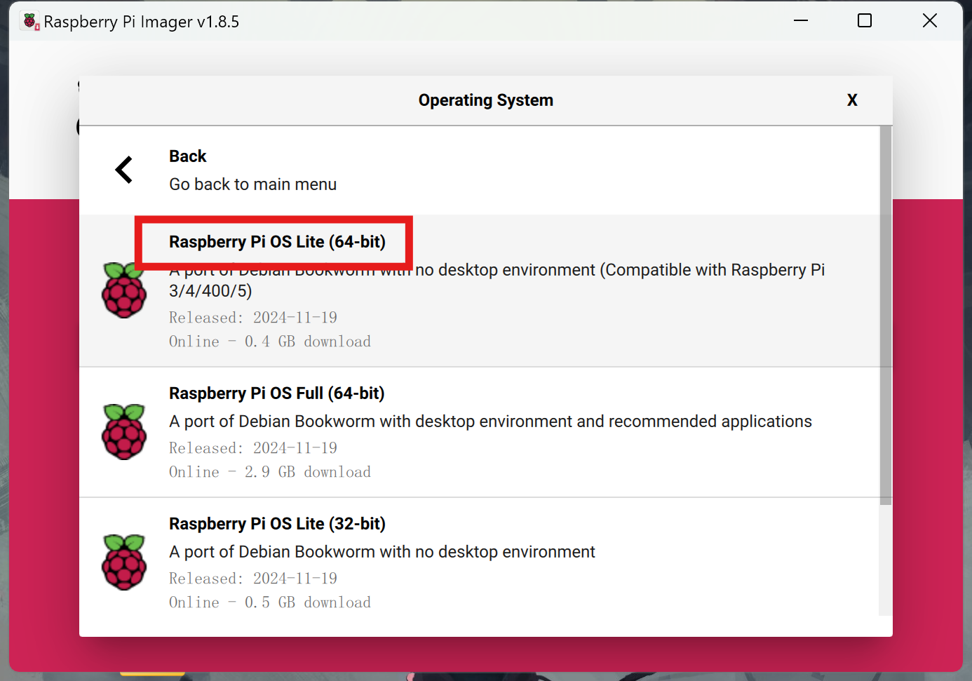

OpenMediaVault does not support installation on the Raspberry Pi OS desktop.
⚠️ Only Raspberry Pi OS Lite versions 11 (Bullseye) and 12 (Bookworm) are supported.
Please make sure you have installed the correct operating system and configured the network. The procedure here is consistent with Installing the Operating System, but when selecting an image, please choose Raspberry Pi OS Lite from Raspberry Pi OS (other).
../../_images/omv-install-13.png

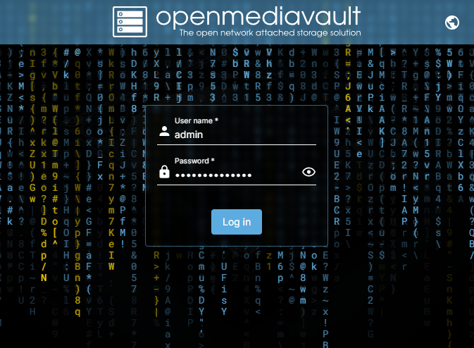

You will see a login page, log in using the default username and password. The default username is admin, and the password is openmediavault.

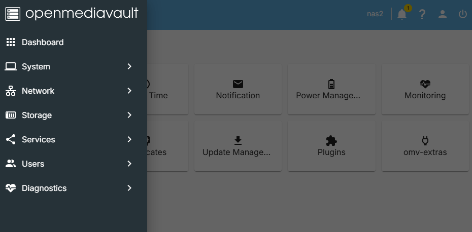

After logging in, you will see the main interface of OpenMediaVault.
../../_images/omv-main3.png

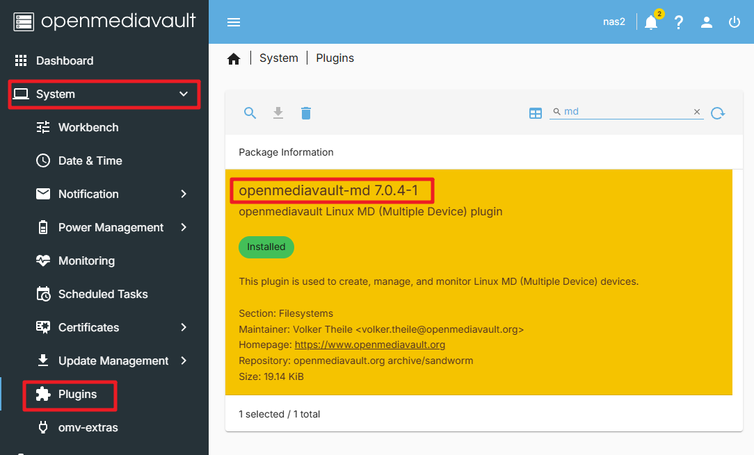

  1. In the System menu click on the Plugins option, search for the openmediavault-md plugin, and install it.
../../_images/omv-raid-13.png

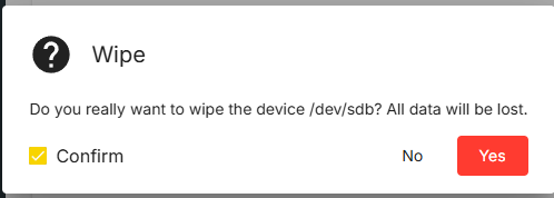

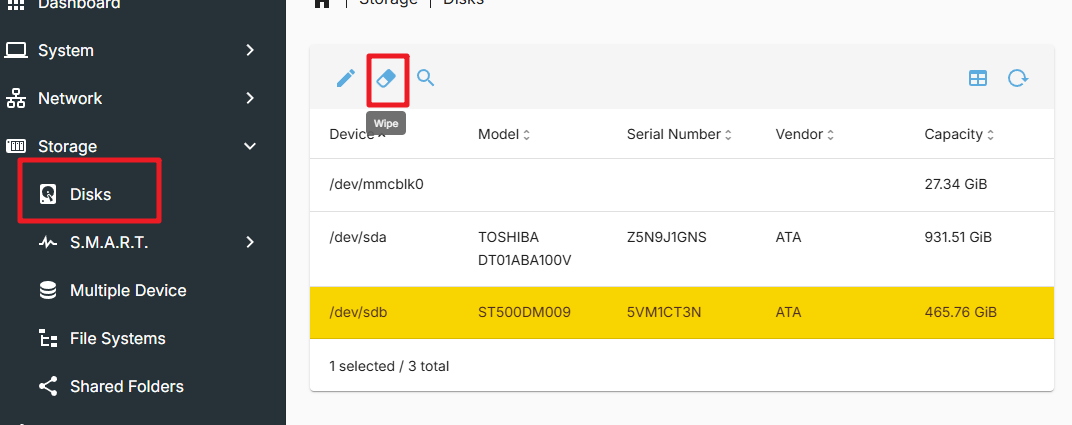

  1. In the Storage menu click on the Disks option, erase two SSDs.
../../_images/omv-raid-23.png
  1. Please note that this action will erase all data on the hard drives, make sure you have backed up all important data.
../../_images/omv-raid-33.png

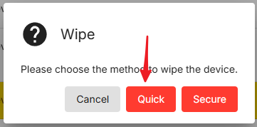

  1. Erase mode select QUICK is sufficient.
../../_images/omv-raid-43.png

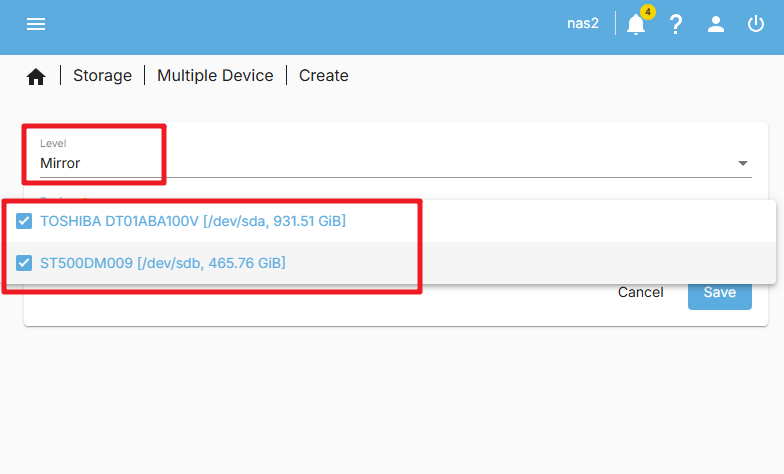

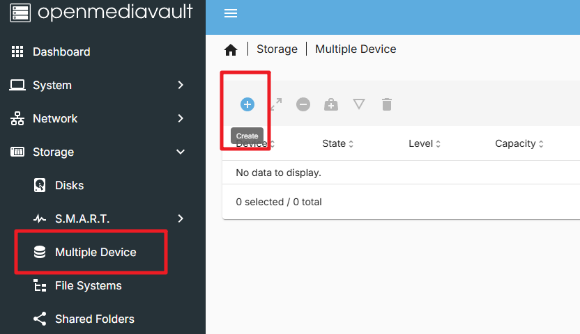

  1. Enter the Multiple Device tab, click Create.
../../_images/omv-raid-53.png
  1. In the Level option, you can choose Stripe (RAID 0) or Mirror (RAID 1). In the Devices option, select the hard drives you just erased. Click Save and wait for the RAID configuration to complete.
../../_images/omv-raid-63.png

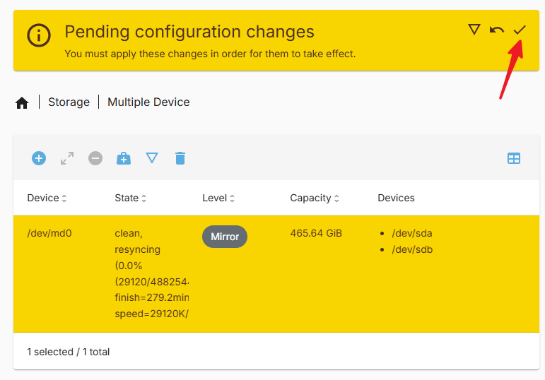

  1. Apply the configuration by clicking on the Apply button.
../../_images/omv-raid-73.png

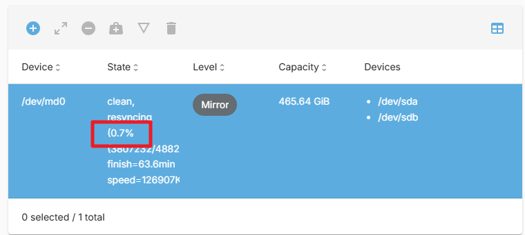

  1. After the RAID configuration is complete, you have to wait the state of the RAID to be 100%.
../../_images/omv-raid-83.png
  1. After the RAID configuration is complete, your hard drives are now in a RAID 0 or RAID 1 configuration, and you can use them as a single storage device.

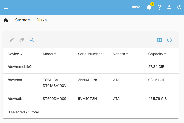

In the main interface of OpenMediaVault, click on the Storage option in the left-side menu. In the Storage page, click on the Disks tab. On the Disks page, you will see all the disks on your Raspberry Pi. Ensure your NVMe PIP has a connected hard drive.
../../_images/omv-disk3.png

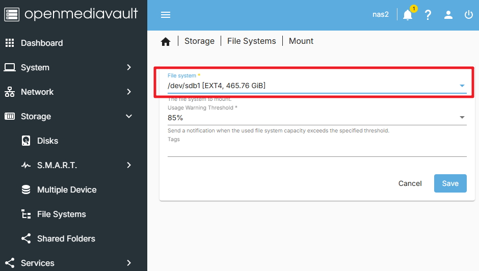

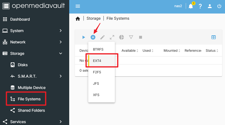

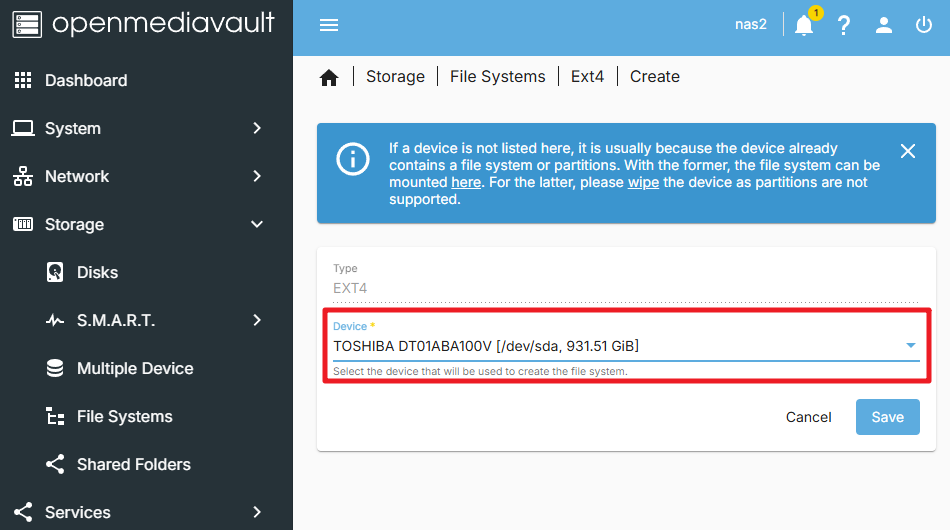

  1. In the sidebar, click the File System option. Then create and mount a file system. Choose ext4 as the file system type.
../../_images/omv-mount3.png
  1. Select Device, and save.
If you have set up the RAID, you will see the RAID device in the list. Just select it and save.
../../_images/omv-mount-23.png

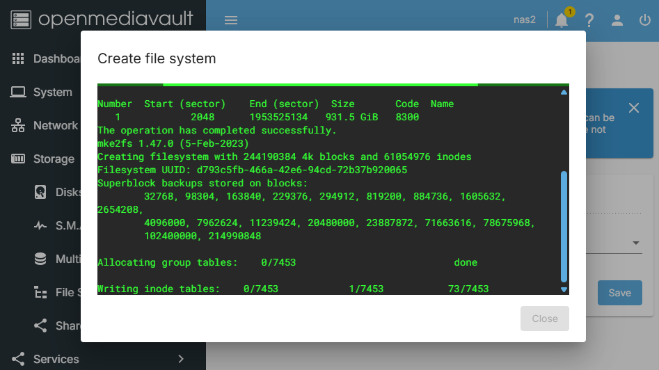

  1. A window will appear, informing you that the file system is being created, please wait a moment.
../../_images/omv-mount-33.png

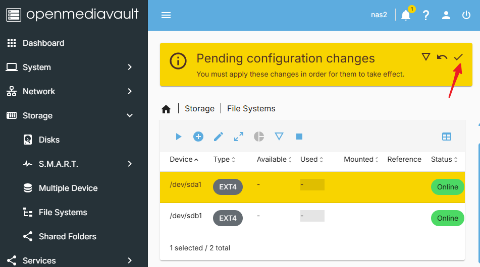

  1. Once done, you will enter the Mount interface, select the file system you just created, and mount it to your Raspberry Pi.
../../_images/omv-mount-43.png
If you are using dual hard drives (and not RAID), you should repeat the above steps to also mount the second hard drive to your Raspberry Pi.
  1. After mounting, please Apply, and then you can see the data on your hard drives in the file system.
../../_images/omv-mount-53.png

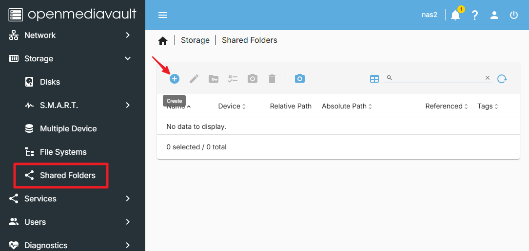

6. Create a Shared Folder
  1. In the Storage page, go to the Shared Folders tab. And click the Create button.
../../_images/omv-share-13.png

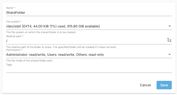

  1. In the Create Shared Folder page, enter the name of the shared folder, select the hard drive you want to share, the path of the shared folder, and set the permissions of the shared folder. Then click the Save button.

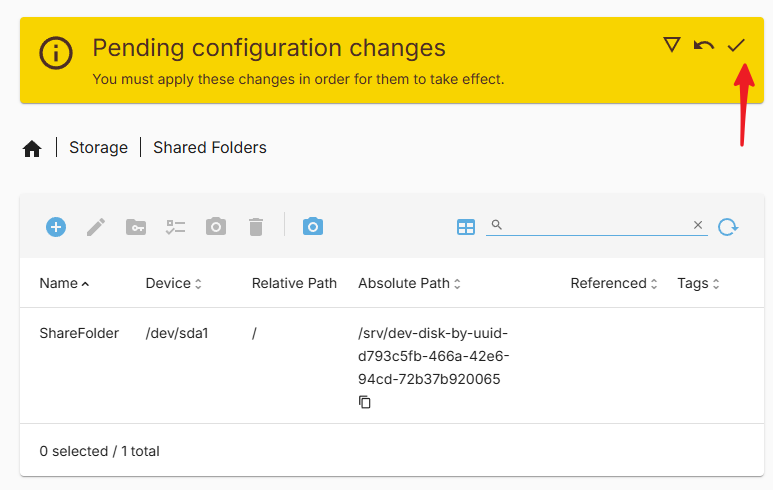

../../_images/omv-share-23.png
  1. Now you can see the shared folder you just created. Confirm it is correct, then apply.
../../_images/omv-share-33.png

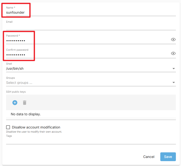

7. Create a New User
To access the folder, we need to create a new user, please follow these steps:

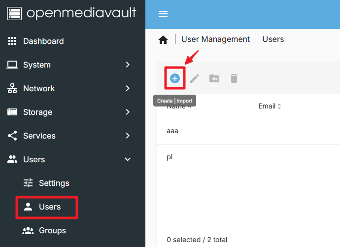

  1. In the User page, click the Create button.
../../_images/omv-user-13.png
  1. In the Create User page, enter the new user’s username and password, then click the Save button.
../../_images/omv-user-23.png
You have now successfully created a new user.

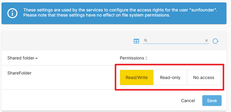

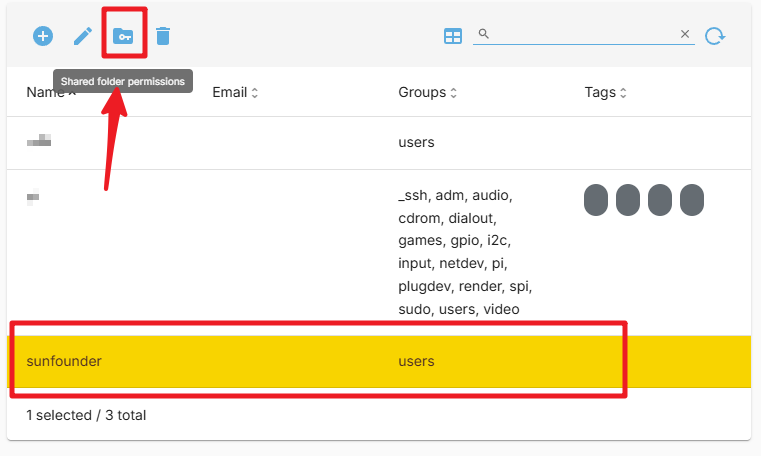

  1. In the Shared Folders page, click on the shared folder you just created. Then click the Permissions button.
../../_images/omv-user-33.png

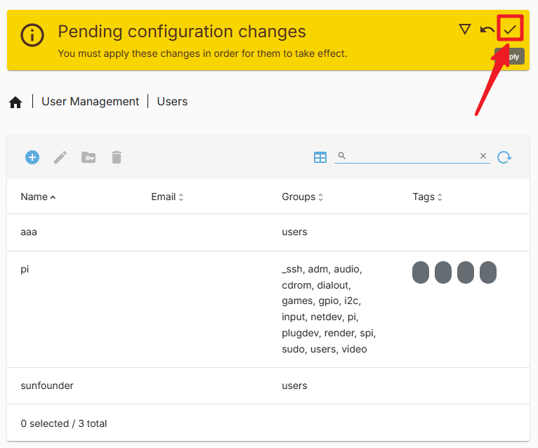

  1. In the Permissions page, set the permissions. Then click the Save button.
../../_images/omv-user-43.png
  1. After completing, click the Apply button.
../../_images/omv-user-53.png
You can now use this new user to access your shared folder.

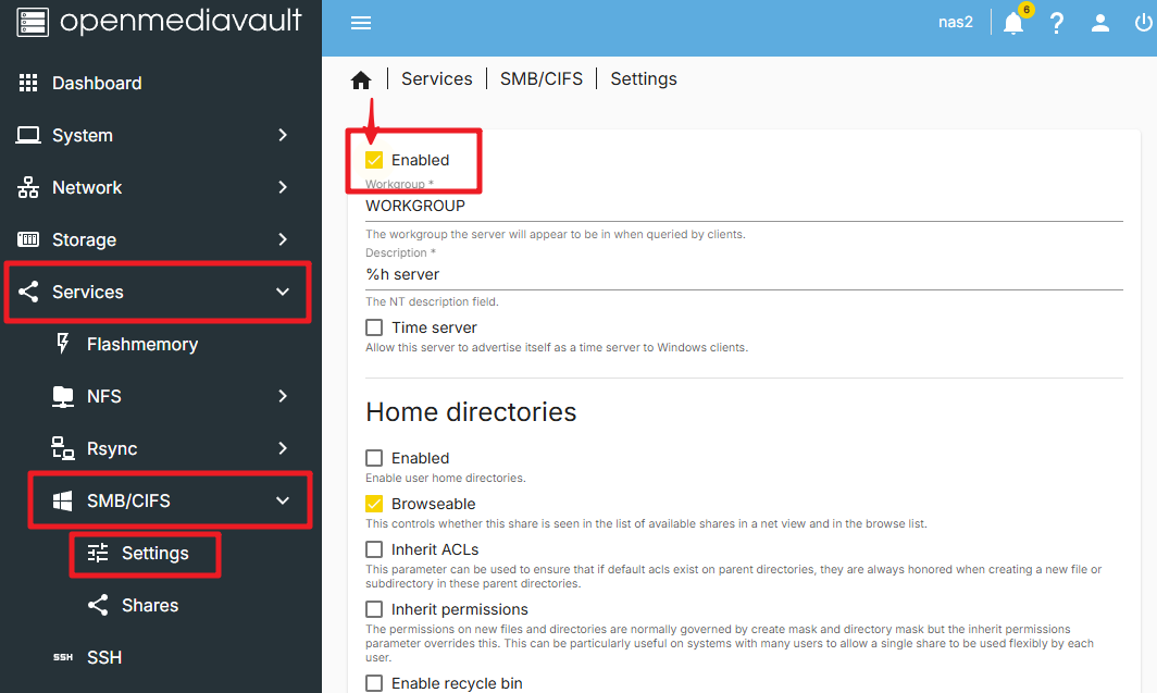

9. Configure the SMB Service
  1. In the Services page, find the SMB/CIFS > Setting tab. And check the Enable option. Then click the Save button.
../../_images/omv-smb-13.png

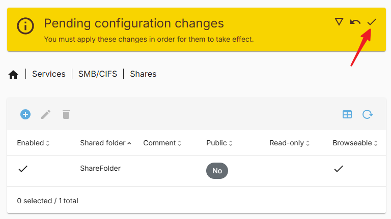

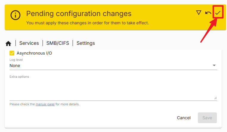

  1. Apply the changes by clicking the Apply button.
../../_images/omv-smb-23.png

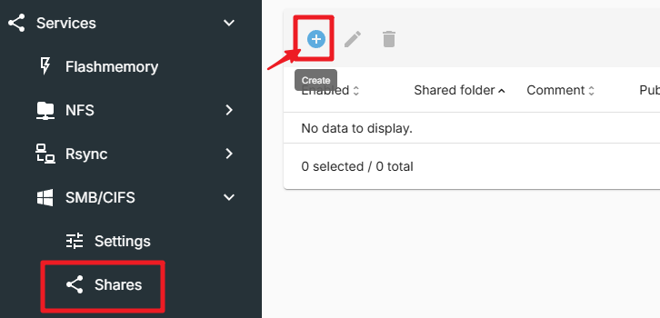

  1. Enter the Shares page, click the Create button.
../../_images/omv-smb-33.png

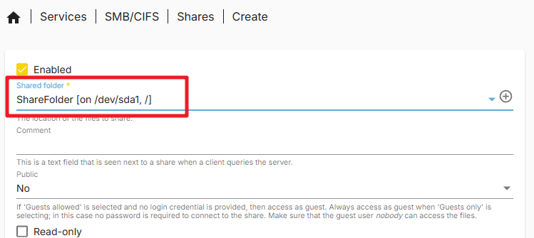

  1. In the Create Share page, select the path of the shared folder. Then click the Save button. Incidentally, there are many options on this page that you can configure as needed.
../../_images/omv-smb-43.png

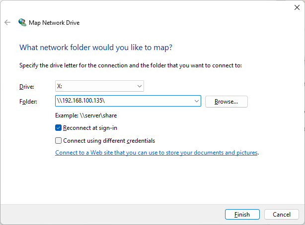

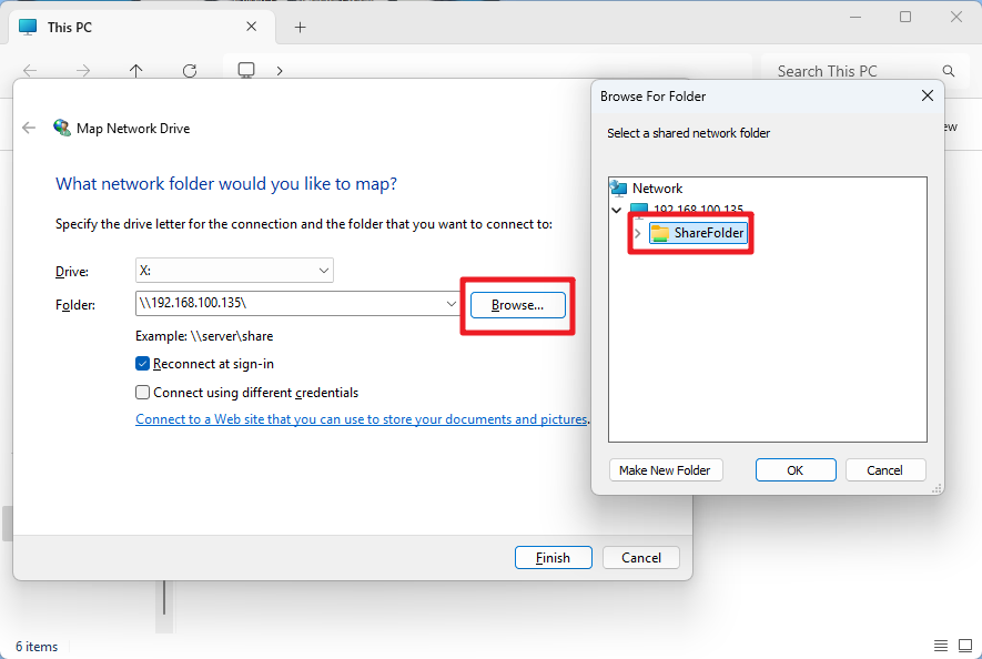

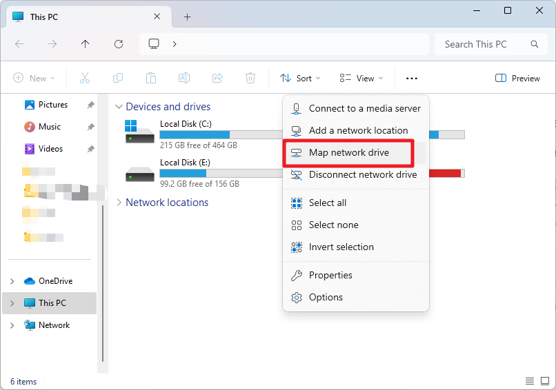

10. Access the Shared Folder on Windows
  1. Open This PC, then click Map network drive.
../../_images/omv-network-location-13.png
  1. In the pop-up dialog box, enter the IP of the Raspberry Pi in the Folder field, for example, \\192.168.1.100\, or the Raspberry Pi’s hostname, for example, \\pi.local\.
../../_images/omv-network-location-23.png
  1. Click the browse button, then select the shared folder you want to access. During this process, you will need to enter the username and password you created earlier.
../../_images/omv-network-location-33.png

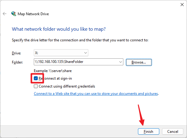

  1. Check “Reconnect at sign-in”, and click the Finish button.
../../_images/omv-network-location-43.png

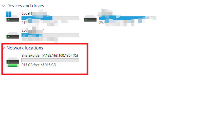

  1. You can now access the NAS shared folder.
../../_images/omv-network-location-53.png

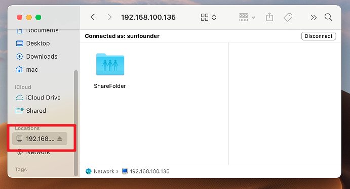

10. Access the Shared Folder on Mac

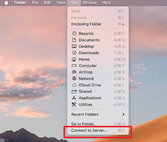

  1. In the Go menu, click Connect to Server.
../../_images/omv-mac-13.png

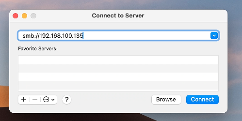

  1. In the pop-up dialog box, enter the IP of the Raspberry Pi, such as smb://192.168.1.100, or the Raspberry Pi’s hostname, such as smb://pi.local.
../../_images/omv-mac-23.png

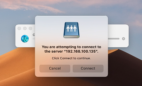

  1. Click the Connect button.
../../_images/omv-mac-33.png

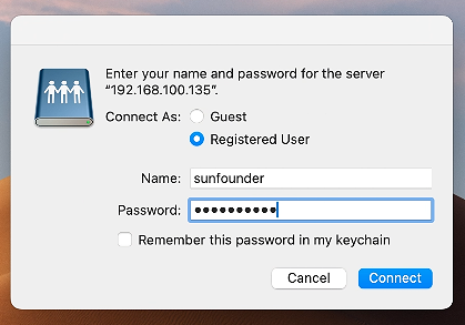

  1. In the pop-up dialog box, enter the username and password you created earlier. Click the Connect button.
../../_images/omv-mac-43.png
