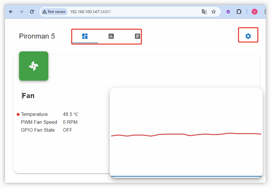

Once you have successfully installed the pironman5 module, the pironman5.service will start automatically upon reboot.
Now you can open the monitoring page in your browser to see the information about your Raspberry Pi, configure the RGB, and control the fan, etc. The page link is: http://<ip>:34001.
This page has Dashboard, History, Log, and a Settings page.
../../_images/dashboard_tab.png
Dashboard
There are multiple cards to view the relevant status of the Raspberry Pi, including:
  • Fan: View the Raspberry Pi’s CPU temperature and the PWM fan speed. GPIO Fan State indicates the status of the RGB fan. At the current temperature, the RGB fan is off.

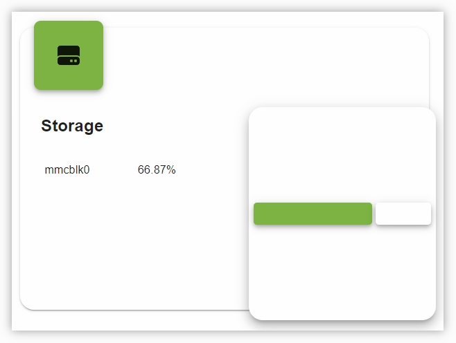

  • Storage: Displays the storage capacity of a Raspberry Pi, showing various disk partitions with their used and available space.
    ../../_images/dashboard_storage2.png

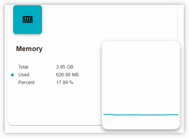

  • Memory: Shows the Raspberry Pi’s RAM usage and percentage.
    ../../_images/dashboard_memory2.png

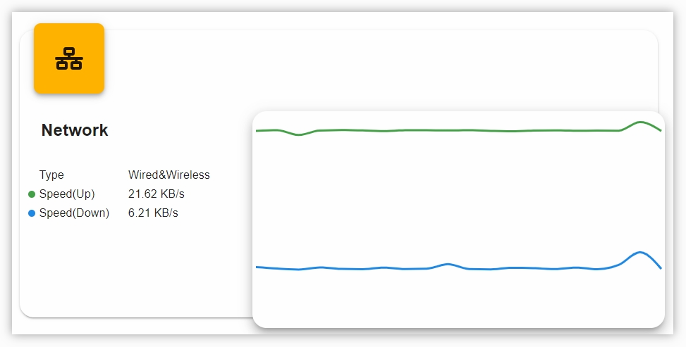

  • Network: Displays the current network connection type, upload, and download speeds.
    ../../_images/dashboard_network2.png

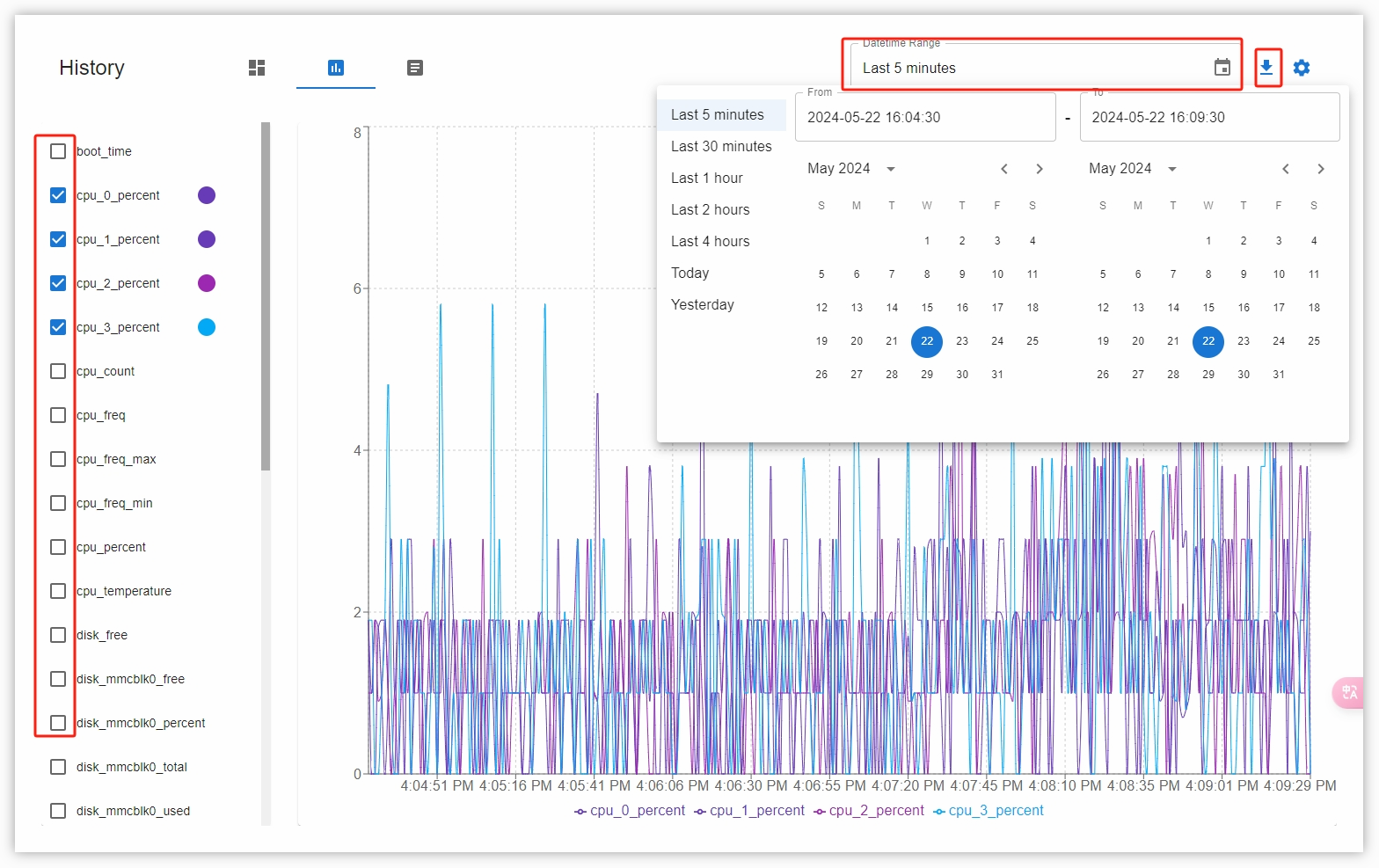

History
The History page allows you to view historical data. Check the data you want to view in the left sidebar, then select the time range to see the data for that period, and you can also click to download it.
../../_images/dashboard_history.png

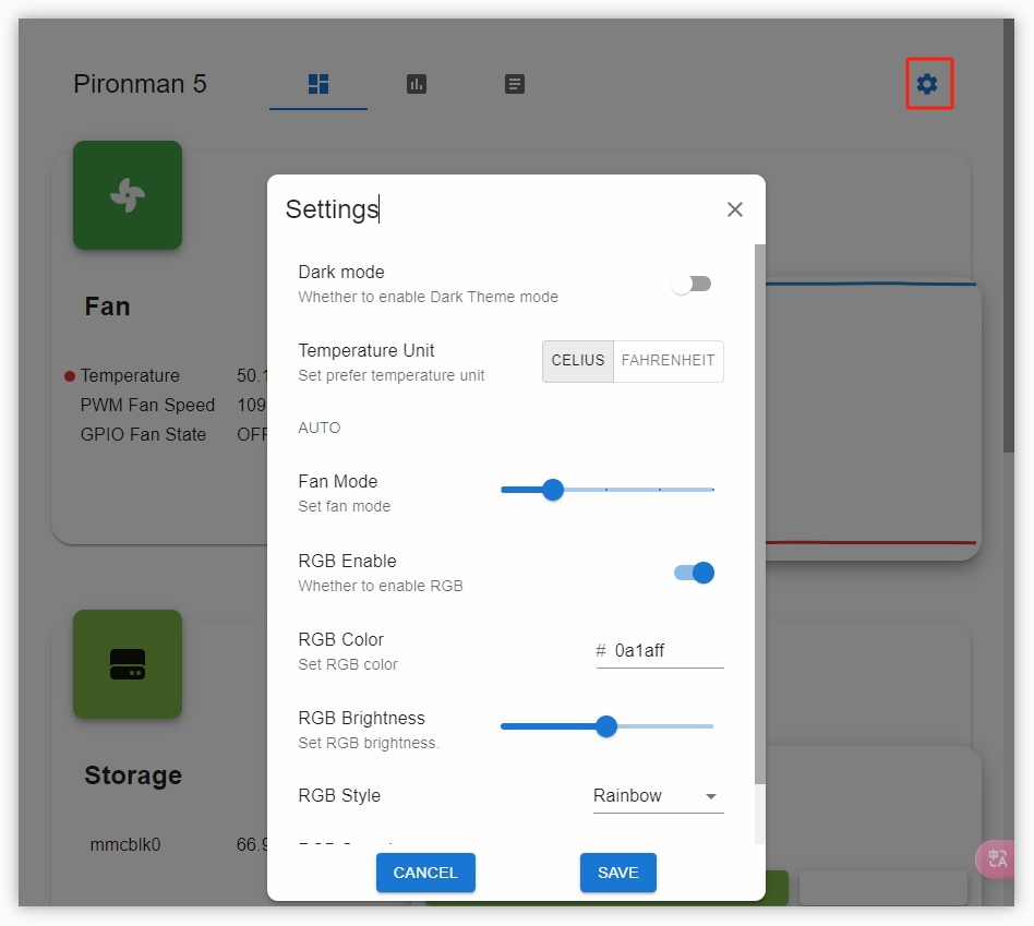

Settings
There is a settings menu in the upper right corner of the page.
After modifying, you need to click the SAVE button at the bottom to save the settings.
../../_images/dashboard_settings.png
  • Dark Mode: Toggle between light and dark mode themes. The theme option is saved in the browser cache. Changing the browser or clearing the cache will revert to the default light theme.
  • Temperature Unit: Set the temperature unit displayed by the system.
  • Fan Mode: You can set the operating mode of the RGB fan. These modes determine the conditions under which the RGB fan will activate.
    • Quiet: The RGB fan will activate at 70°C.
    • Balanced: The RGB fan will activate at 67.5°C.
    • Cool: The RGB fan will activate at 60°C.
    • Performance: The RGB fan will activate at 50°C.
    • Always On: The RGB fan will always be on.
    For instance, if set to Performance mode, the RGB fan will activate at 50°C.
    After saving, if the CPU temperature exceeds 50°C, you will see the GPIO Fan State change to ON in the Dashboard, and the RGB fan will start spinning.
    ../../_images/dashboard_rgbfan_on.png
  • RGB Brightness: You can adjust the brightness of the RGB LEDs with a slider.
  • RGB Color: Set the color of the RGB LEDs.
  • RGB Style: Choose the RGB LEDs display mode. Options include Solid, Breathing, Flow, Flow_reverse, Rainbow, Rainbow Reverse, and Hue Cycle.
If you set the RGB Style to Rainbow, Rainbow Reverse, and Hue Cycle, you will not be able to set the color.
  • RGB Speed: Set the speed of the RGB LED changes.
