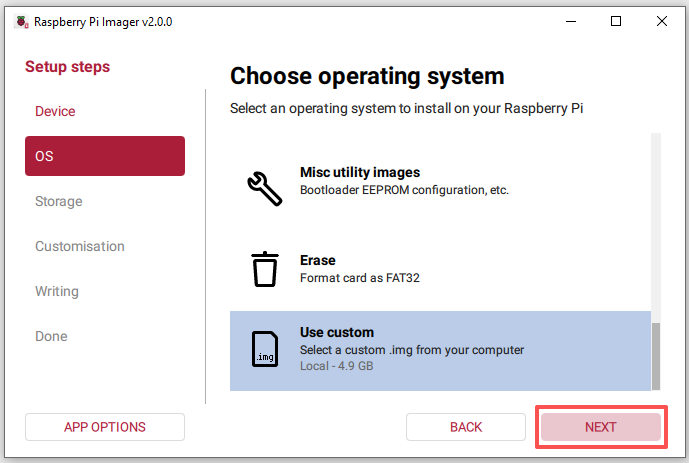

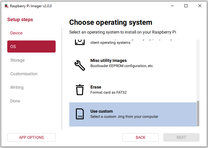

  4. Go to the OS section, scroll to the bottom, and select Use custom.
    ../../_images/imager_use_custom1.png

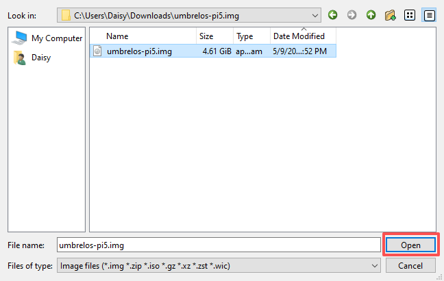

  5. Select the Umbrel OS image file you downloaded and extracted earlier, then click Open.
    ../../_images/umbrel_choose_umbrel1.png

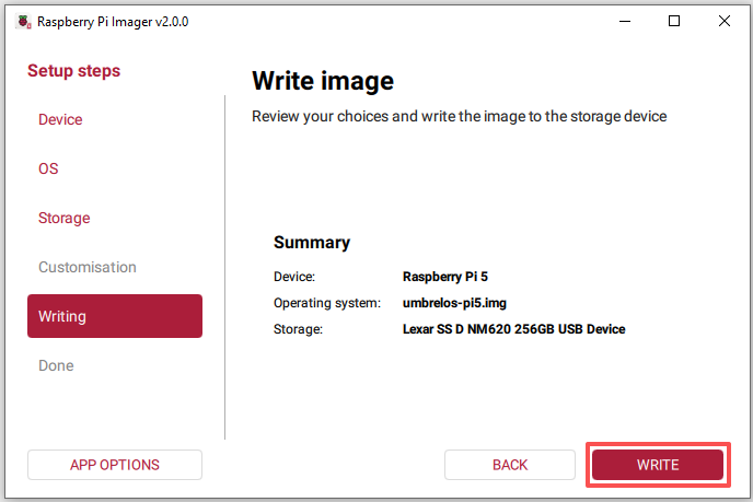

  8. Review all settings carefully, then click WRITE.
    ../../_images/imager_write_umbrel1.png

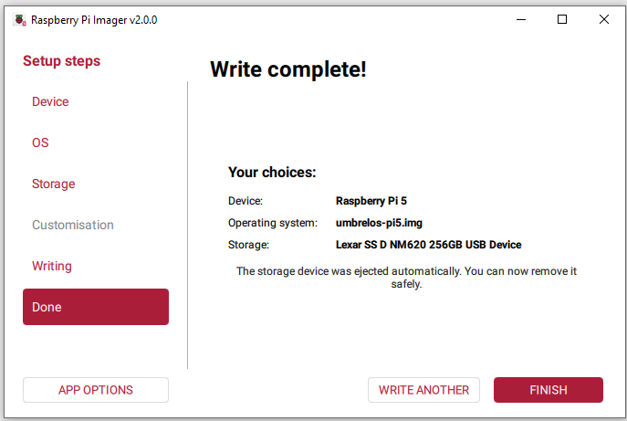

  10. When the “Write Complete” message appears, the image has been written and verified successfully.
    ../../_images/imager_umbrel_finish1.png
