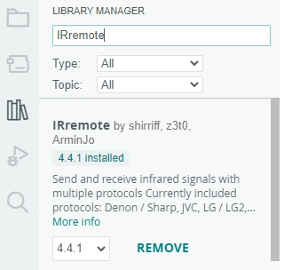

  • The IRremote library is used here, you can install it from the Library Manager.
    ../_images/lib_ir.png
