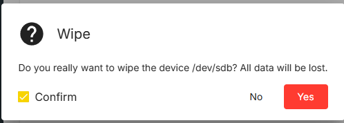

  1. In the Storage menu click on the Disks option, erase two SSDs.
_images/omv-raid-2.png
  1. Please note that this action will erase all data on the hard drives, make sure you have backed up all important data.
_images/omv-raid-3.png
  1. Erase mode select QUICK is sufficient.

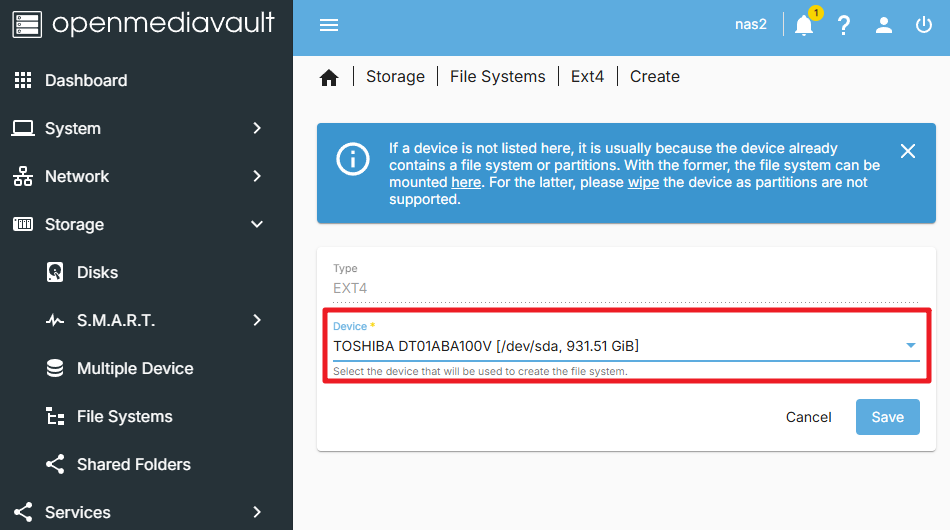

  1. In the sidebar, click the File System option. Then create and mount a file system. Choose ext4 as the file system type.
_images/omv-mount.png
  1. Select Device, and save.
If you have set up the RAID, you will see the RAID device in the list. Just select it and save.
_images/omv-mount-2.png

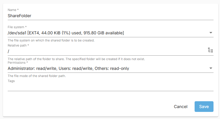

6. Create a Shared Folder
  1. In the Storage page, go to the Shared Folders tab. And click the Create button.
_images/omv-share-1.png
  1. In the Create Shared Folder page, enter the name of the shared folder, select the hard drive you want to share, the path of the shared folder, and set the permissions of the shared folder. Then click the Save button.
_images/omv-share-2.png

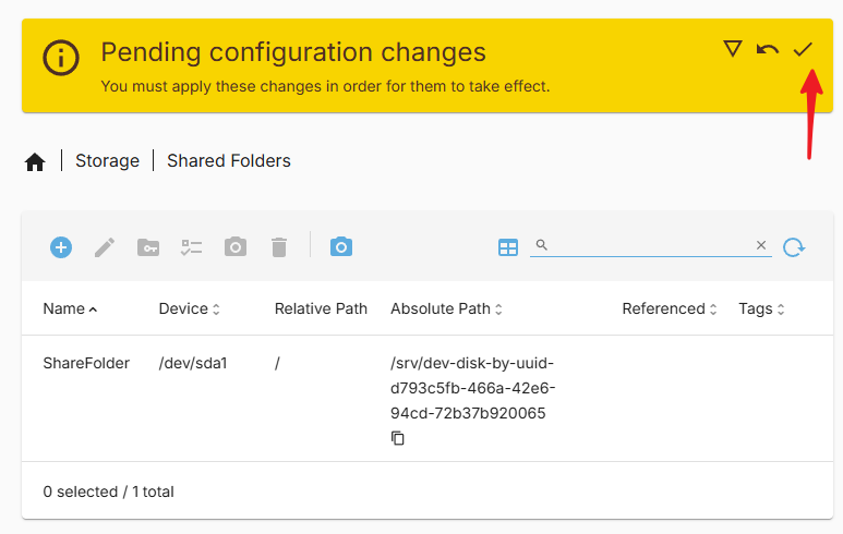

  1. Now you can see the shared folder you just created. Confirm it is correct, then apply.
_images/omv-share-3.png

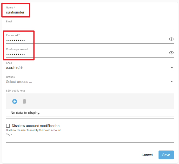

7. Create a New User
To access the folder, we need to create a new user, please follow these steps:
  1. In the User page, click the Create button.
_images/omv-user-1.png
  1. In the Create User page, enter the new user’s username and password, then click the Save button.
_images/omv-user-2.png

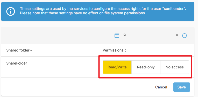

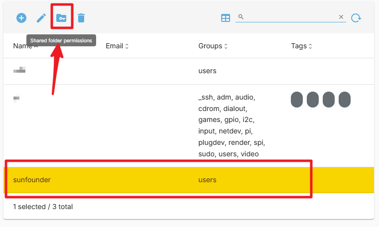

8. Set Permissions for the New User
  1. In the Shared Folders page, click on the shared folder you just created. Then click the Permissions button.
_images/omv-user-3.png
  1. In the Permissions page, set the permissions. Then click the Save button.
_images/omv-user-4.png

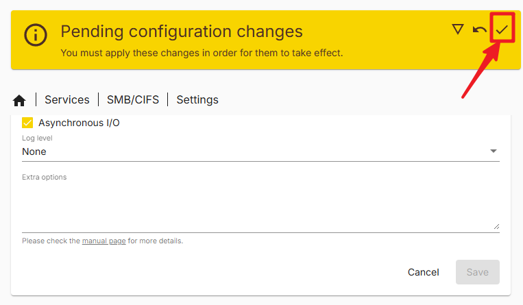

  1. In the Services page, find the SMB/CIFS > Setting tab. And check the Enable option. Then click the Save button.
_images/omv-smb-1.png
  1. Apply the changes by clicking the Apply button.
_images/omv-smb-2.png

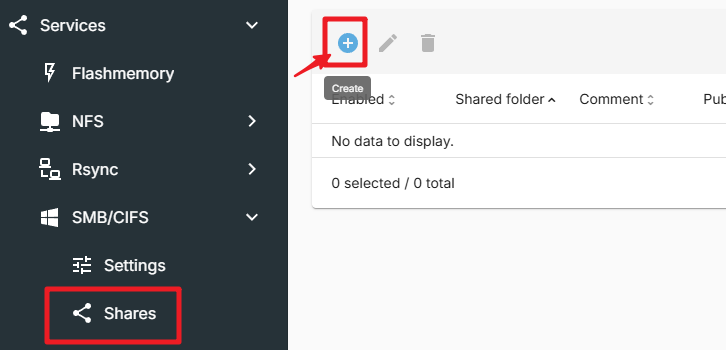

  1. Enter the Shares page, click the Create button.
_images/omv-smb-3.png

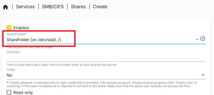

  1. In the Create Share page, select the path of the shared folder. Then click the Save button. Incidentally, there are many options on this page that you can configure as needed.
_images/omv-smb-4.png

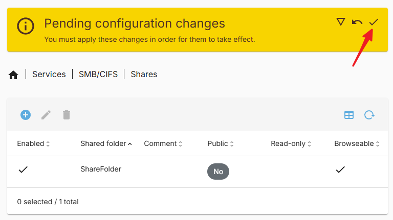

  1. Click Apply.
_images/omv-smb-5.png

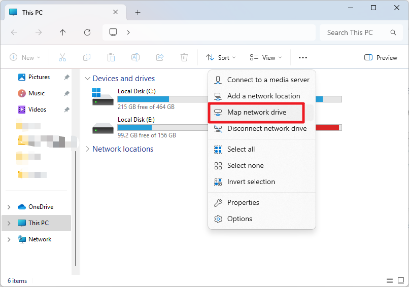

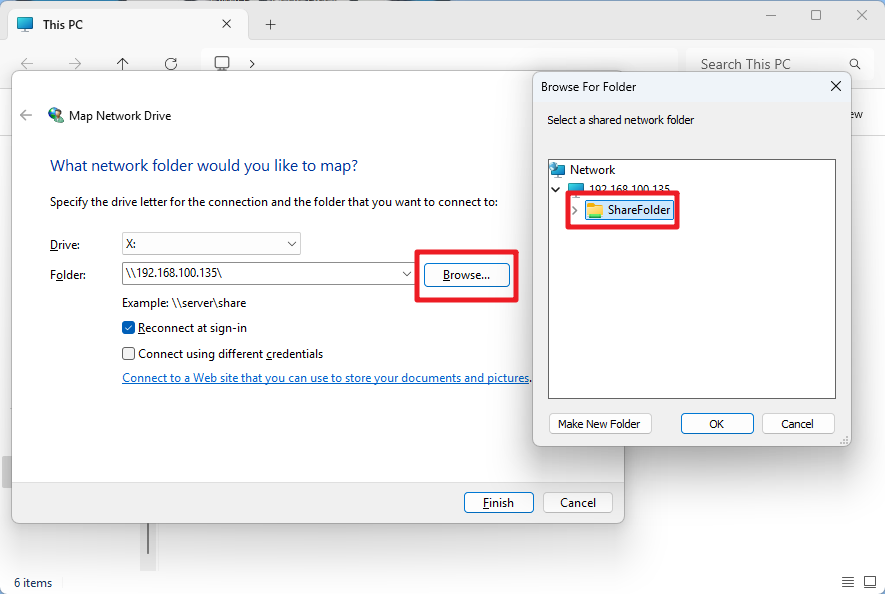

10. Access the Shared Folder on Windows
  1. Open This PC, then click Map network drive.
_images/omv-network-location-1.png

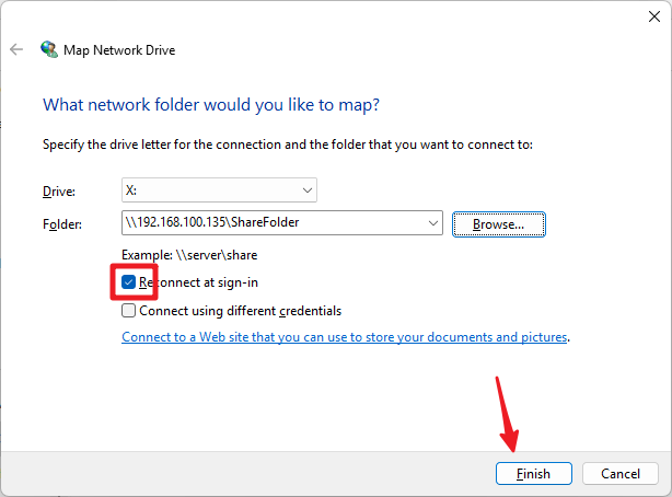

  1. In the pop-up dialog box, enter the IP of the Raspberry Pi in the Folder field, for example, \\192.168.1.100\, or the Raspberry Pi’s hostname, for example, \\pi.local\.
_images/omv-network-location-2.png
  1. Click the browse button, then select the shared folder you want to access. During this process, you will need to enter the username and password you created earlier.
_images/omv-network-location-3.png
  1. Check “Reconnect at sign-in”, and click the Finish button.
_images/omv-network-location-4.png
  1. You can now access the NAS shared folder.

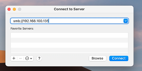

10. Access the Shared Folder on Mac

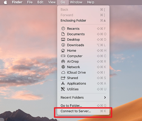

  1. In the Go menu, click Connect to Server.
_images/omv-mac-1.png

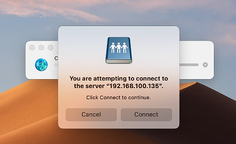

  1. In the pop-up dialog box, enter the IP of the Raspberry Pi, such as smb://192.168.1.100, or the Raspberry Pi’s hostname, such as smb://pi.local.
_images/omv-mac-2.png
  1. Click the Connect button.
_images/omv-mac-3.png

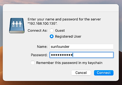

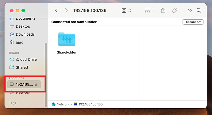

  1. In the pop-up dialog box, enter the username and password you created earlier. Click the Connect button.
_images/omv-mac-4.png
