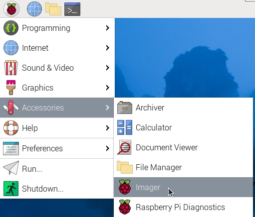

If your Micro SD card has a desktop version of the system installed, you can use an imaging tool (like Raspberry Pi Imager) to burn the system to the SSD. This example uses Raspberry Pi OS bookworm, but other systems might require installing the imaging tool first.
  1. Connect a display or access the Raspberry Pi desktop through VNC Viewer. Then click Raspberry Pi logo -> Accessories -> Imager.

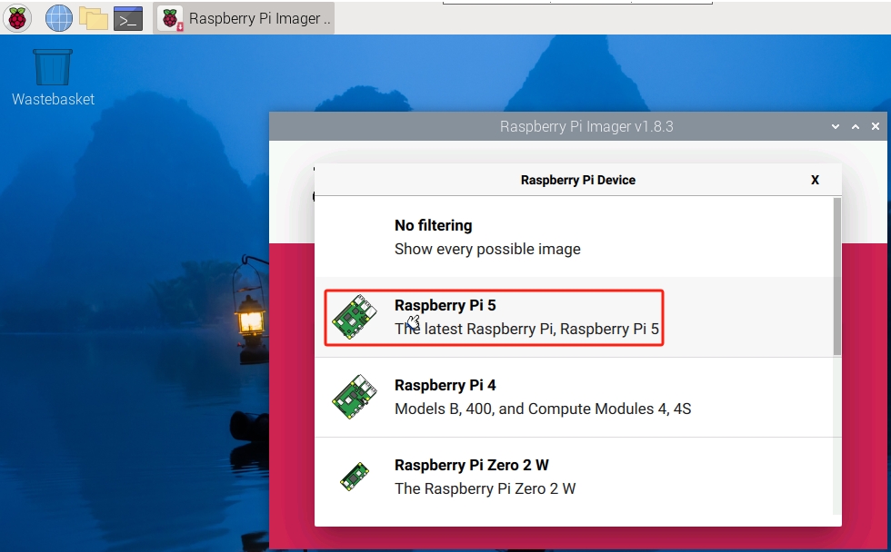

  2. Within the Raspberry Pi Imager, click Raspberry Pi Device and select the Raspberry Pi 5 model from the dropdown list.
    ../_images/ssd_pi5.png

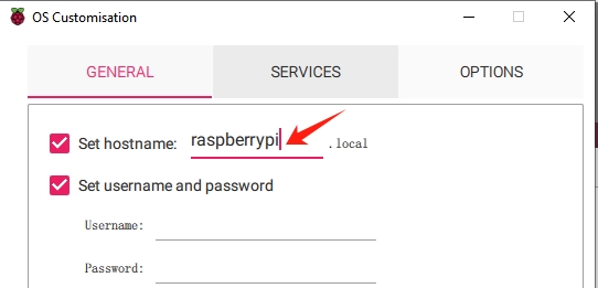

  6. Define a hostname for your Raspberry Pi.
    The hostname is your Raspberry Pi’s network identifier. You can access your Pi using <hostname>.local or <hostname>.lan.
    ../_images/os_set_hostname.png

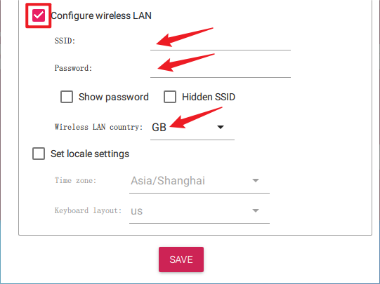

  8. Configure the wireless LAN by providing your network’s SSID and Password.
    Set the Wireless LAN country to the two-letter ISO/IEC alpha2 code corresponding to your location.
    ../_images/os_set_wifi.png

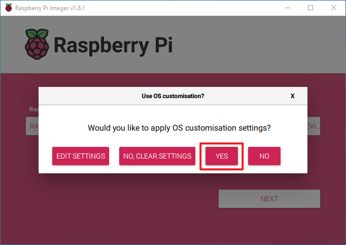

  11. When you’ve finished entering OS customisation settings, click Save to save your customisation. Then, click Yes to apply them when writing the image.
    ../_images/os_click_yes.png

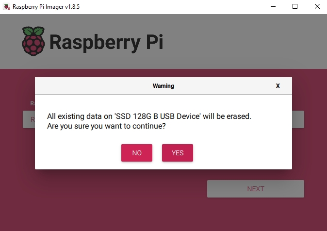

  12. If the NVMe SSD contains existing data, ensure you back it up to prevent data loss. Proceed by clicking Yes if no backup is needed.
    ../_images/nvme_erase.png
