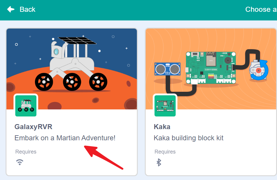

  5. Select and load the GalaxyRVR extension within the APP.
    ../_images/connet_app_05.png

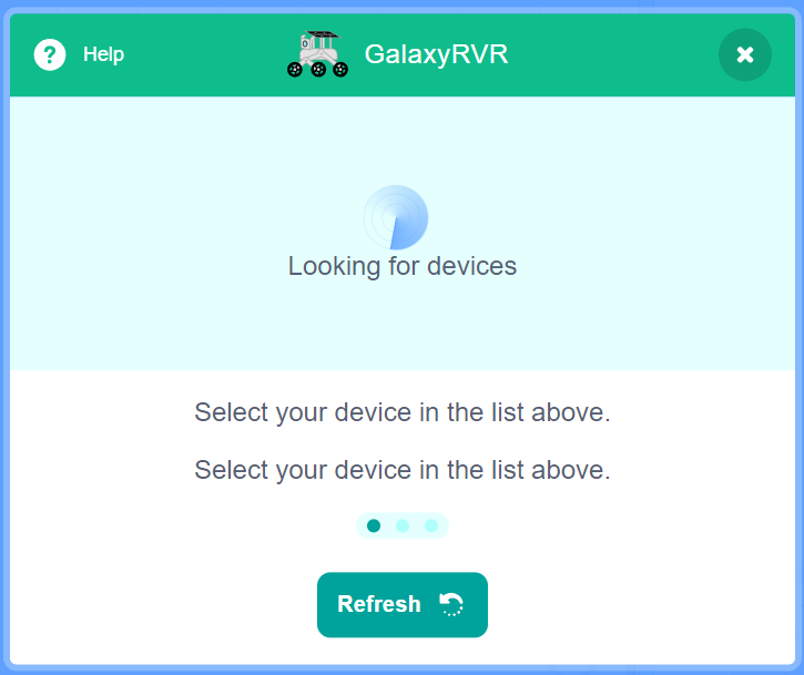

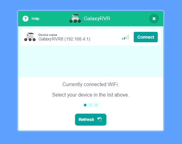

  6. The APP will automatically scan and search for available GalaxyRVR devices.
    ../_images/connet_app_06.png
  7. Select your GalaxyRVR from the list to connect.
    ../_images/reconnect_2.png

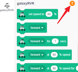

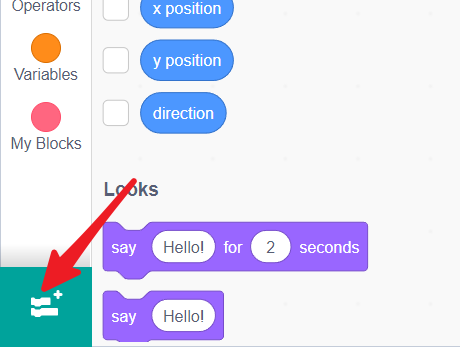

If you close the pop-up window, you can also reconnect by clicking this button in the GalaxyRVR category.
../_images/reconnect_1.png
Find your GalaxyRVR and click connect.

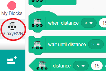

  1. In the coding interface, find the dedicated GalaxyRVR category containing all the rover control blocks.
    ../_images/3_rvr_catego.png

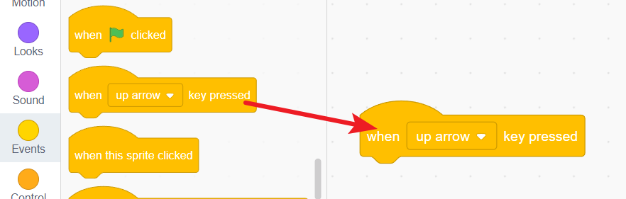

  2. While we typically use the green flag to start programs, there are other ways to trigger actions. Find the when up arrow key pressed block in the Events category - this will execute code whenever you press that specific key.
    ../_images/3_rvr_when_arrow.png

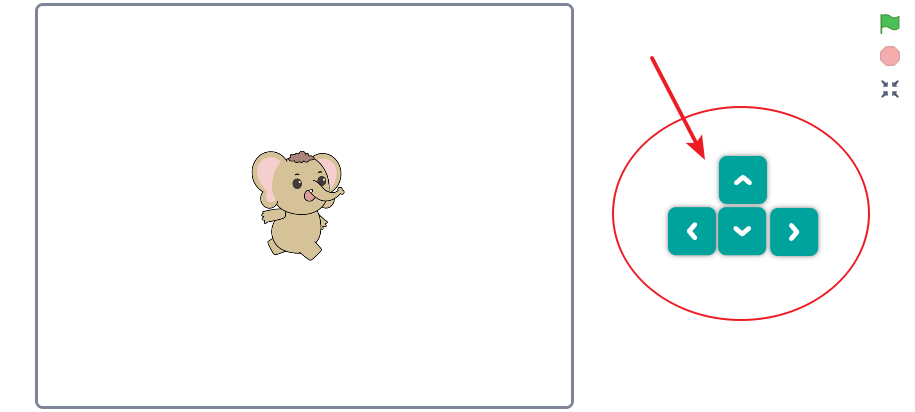

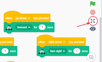

  5. Click the stage expansion button to enter the full control mode.
    ../_images/3_rvr_stage.png
  6. You’ll now see an enlarged stage with virtual direction keys. Press these keys and watch as you directly control your GalaxyRVR’s movements in real-time!
    ../_images/3_rvr_stage2.png
