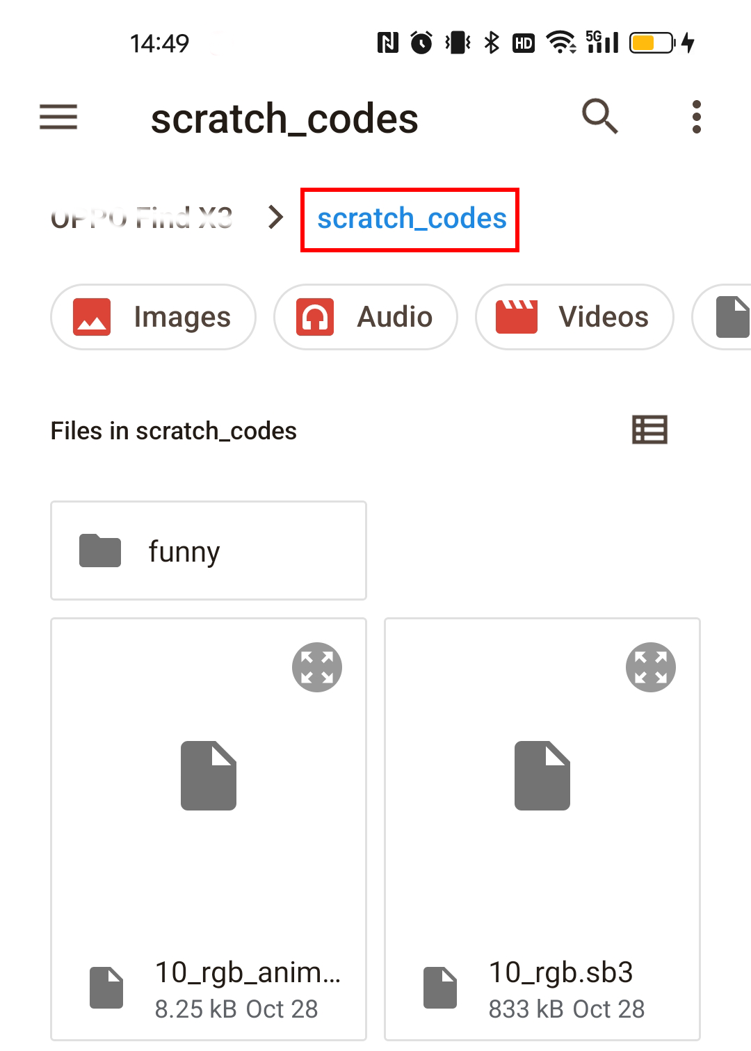

  2. Extract the downloaded file and transfer the scratch_codes folder to your mobile device. You can use any file transfer tool, such as ES File Explorer or File Transfer Assistant.

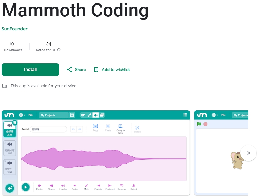

  3. Search for Mammoth Coding on Google Play or the Apple App Store and install it.

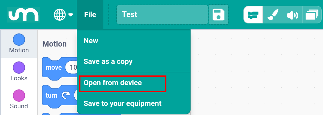

  7. In the app, tap File > Open from device to browse local files.

  8. Select a .sb3 file to open it.
    ../_images/scratch_mobile_save.png

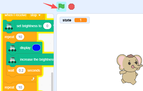

  9. Tap the the green flag icon to start the script.
    ../_images/scratch_run.png
