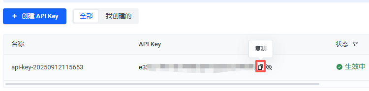

Get and Save your API Key
  1. Log in to Volcengine.
  2. In the left menu, scroll down to API Key Management → Create API Key.
    ../_images/llm_doubao_create.png
  3. Choose a name and click Create.
    ../_images/llm_doubao_name.png
  4. Click the Show API Key icon and copy it.
    ../_images/llm_doubao_copy.png
