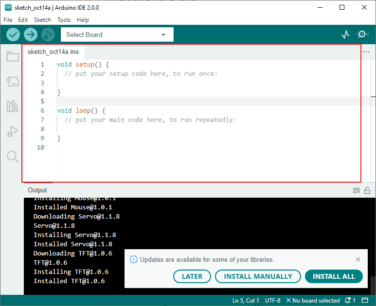

When you open the Arduino IDE for the first time or create a new sketch, you will see a page like this, where the Arduino IDE creates a new file for you, which is called a “sketch”.
These sketch files have a regular temporary name, from which you can tell the date the file was created.

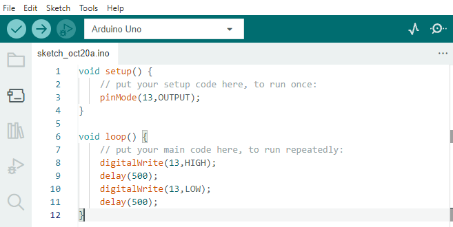

sketch_oct14a.inomeans October 14th first sketch,.inois the file format of this sketch.Now let’s try to create a new sketch. Copy the following code into the Arduino IDE to replace the original code.
void setup() { // put your setup code here, to run once: pinMode(13,OUTPUT); } void loop() { // put your main code here, to run repeatedly: digitalWrite(13,HIGH); delay(500); digitalWrite(13,LOW); delay(500); }

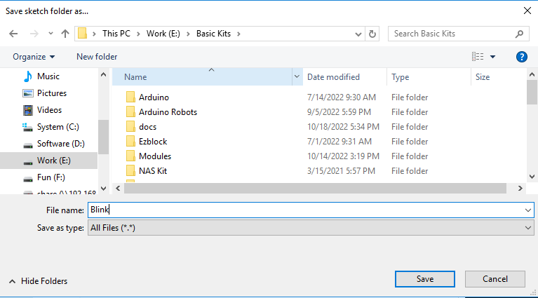

Press
Ctrl+Sor click File -> Save. The Sketch is saved in:C:\Users\{your_user}\Documents\Arduinoby default, you can rename it or find a new path to save it.
After successful saving, you will see that the name in the Arduino IDE has been updated.
