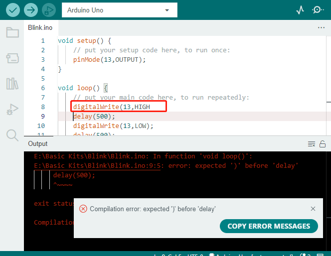

You can use it to find mistakes if you delete some characters or type a few letters by mistake. From the message bar, you can see where and what type of errors occurred.
../_images/sp221014_175307.png

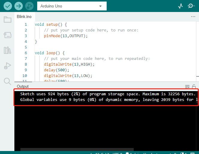

If there are no errors, you will see a message like the one below.
../_images/sp221014_175512.png

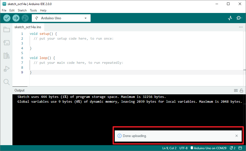

3. Upload sketch
After completing the above steps, click the Upload button to upload this sketch to the board.
../_images/sp221014_175614.png
If successful, you will be able to see the following prompt.
../_images/sp221014_175654.png

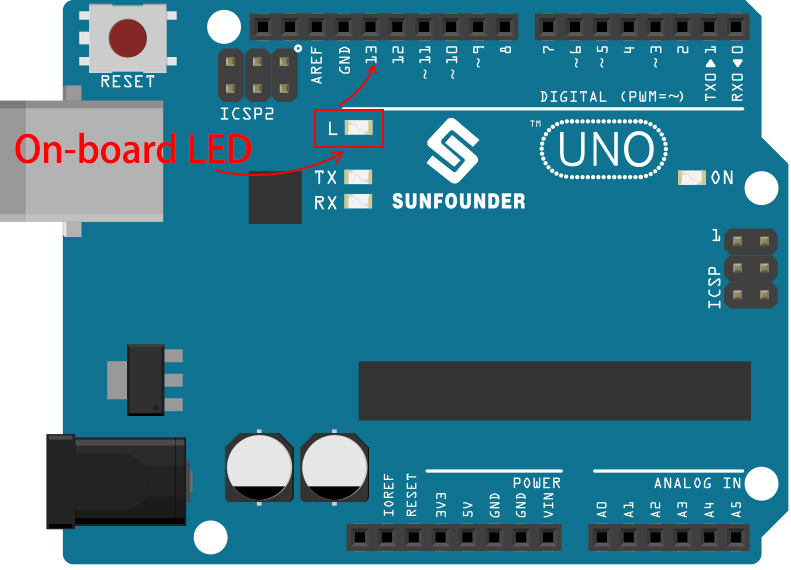

At the same time, the on-board LED blink.
