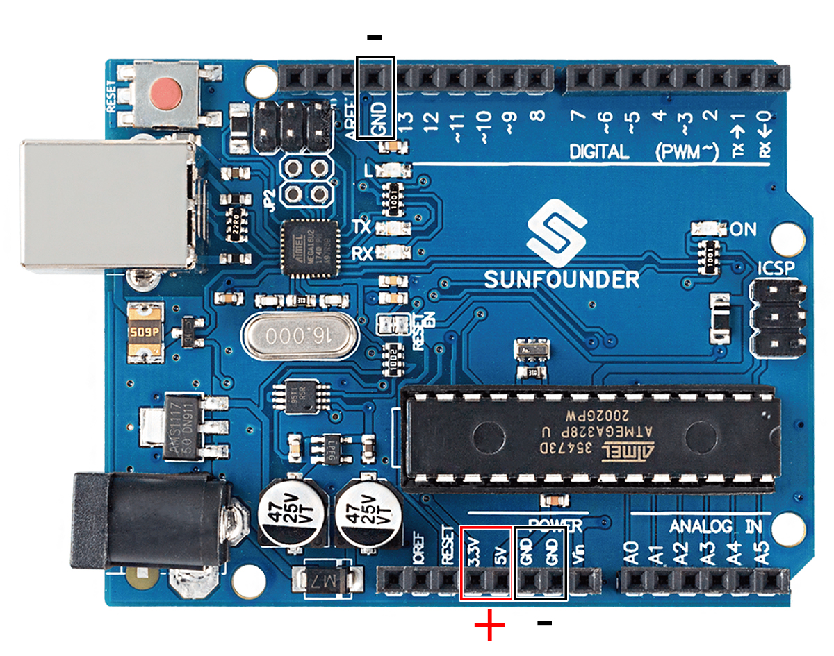

The Arduino Board has some power output pins (positive) and some ground pins (negative). You can use these pins as the positive and negative sides of the power supply by plugging the power source into the board.

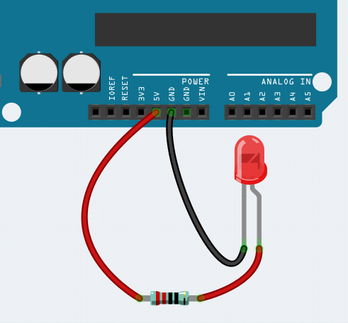

With electricity, you can create works with light, sound, and motion. You can light up an LED by connecting the long pin to the positive terminal and the short pin to the negative terminal. The LED will break down very quickly if you do this, so you need to add a 220* resistor inside the circuit to protect it.
The circuit they form is shown below.

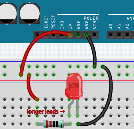

Let us follow the direction of the current to build the circuit!
../_images/sp221014_182229_2.png
  1. In this circuit, we use the 5V pin of the board to power the LED. Use a male-to-male (M2M) jumper wire to connect it to the red power bus.
  2. To protect the LED, the current must pass through a 220 ohm resistor. Connect one end (either end) of the resistor to the red power bus, and the other end to the free row of the breadboard.
    The color ring of the 220 ohm resistor is red, red, black, black and brown.
  3. If you pick up the LED, you will see that one of its leads is longer than the other. Connect the longer lead to the same row as the resistor, and the shorter lead to the other row.
    The longer lead is the anode, which represents the positive side of the circuit; the shorter lead is the cathode, which represents the negative side.
    The anode needs to be connected to the GPIO pin through a resistor; the cathode needs to be connected to the GND pin.
  4. Using a male-to-male (M2M) jumper wire, connect the LED short pin to the breadboard’s negative power bus.
  5. Connect the GND pin of board to the negative power bus using a jumper.

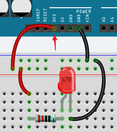

Protection of the circuit¶
Current is the rate at which electrons flow past a point in a complete electrical circuit. At its most basic, current = flow. An ampere (AM-pir), or amp, is the international unit used for measuring current. It expresses the quantity of electrons (sometimes called “electrical charge”) flowing past a point in a circuit over a given time.
The driving force (voltage) behind the flow of current is called voltage and is measured in volts (V).
Resistance (R) is the property of the material that restricts the flow of current, and it is measured in ohms (Ω).
According to Ohm’s law (as long as the temperature remains constant), current, voltage, and resistance are proportional. A circuit’s current is proportional to its voltage and inversely proportional to its resistance.
Therefore, current (I) = voltage (V) / resistance (R).
About Ohm’s law we can do a simple experiment.
../_images/sp221014_183107.png
By changing the wire connecting 5V to 3.3V , the LED gets dimmer. If you change the resistor from 220ohm to 1000ohm (color ring: brown, black, black, brown and brown), you will notice that the LED becomes dimmer than before. The larger the resistor, the dimmer the LED.

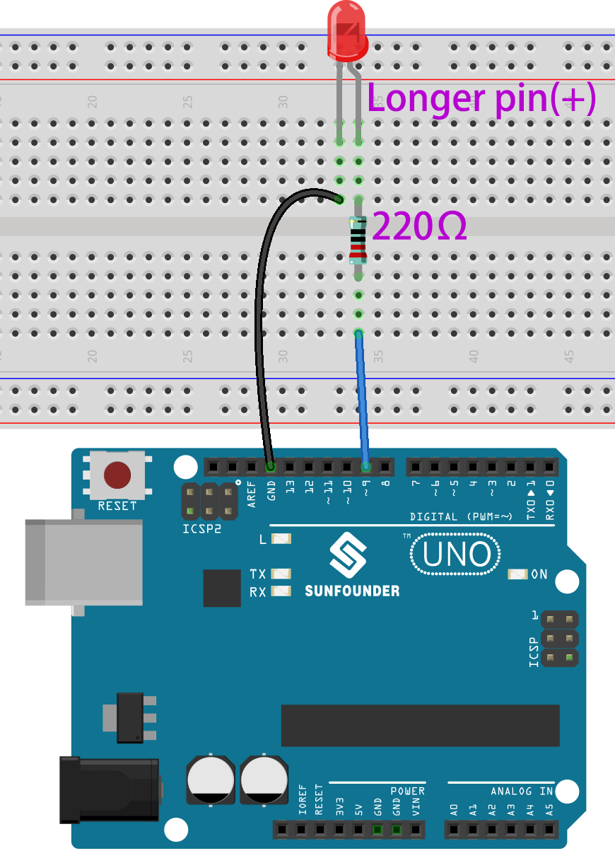

Control circuit with Arduino¶
Now that we have a basic understanding of Arduino programming and electronic circuits, it’s time to face the most critical question: How to control circuits with Arduino.
Simply put, the way Arduino controls a circuit is by changing the level of the pins on the board. For example, when controlling an on-board LED, it is writing a high or low level signal to pin 13.
Now let’s try to code the Arduino board to control the blinking LED on the breadboard. Build the circuit so that the LED is connected to pin 9.
../_images/wiring_led.png
Next, upload this sketch to the Arduino development board.
int ledPin = 9;
int delayTime = 500;
void setup() {
    pinMode(ledPin,OUTPUT);
void loop() {
    digitalWrite(ledPin,HIGH);
    delay(delayTime);
    digitalWrite(ledPin,LOW);
    delay(delayTime);
This sketch is very similar to the one we used to control the blinking of the on-board LED, the difference is that the value of ledPin has been changed to 9. This is because we are trying to control the level of pin 9 this time.
Now you can see the LED on the breadboard blinking.
