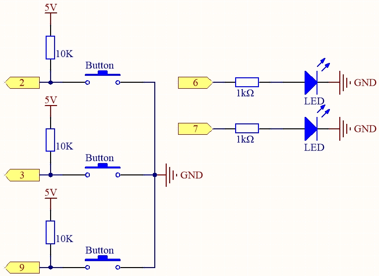

Schematic
../_images/wiring_reaction_game.png
Wiring
../_images/6.5_reaction_game_bb.png

  1. Initialize the buttons and LEDs, 2 interrupt are used here to read the button status.
    void setup()
        attachInterrupt(digitalPinToInterrupt(buttonPin1), pressed1, FALLING);
        attachInterrupt(digitalPinToInterrupt(buttonPin2), pressed2, FALLING);
  2. If the rstBtn button is pressed, the game starts again. At a random time between 2 and 5ms, make one of the LEDs light up.
    void loop()
        if (flag == -1 && digitalRead(rstBtn) == LOW) {
            digitalWrite(ledPin1, LOW);
            digitalWrite(ledPin2, LOW);
            Serial.println("Waiting...");
            int randomTime = random(2000, 5000);
            delay(randomTime);
            timer = millis();
            flag = randomTime % 2;
            Serial.println("Light!");
            if (flag == 0) {
                digitalWrite(ledPin1, HIGH);
            } else if (flag == 1) {
                digitalWrite(ledPin2, HIGH);
        delay(200);
    • When flag is -1 and rstBtn button is pressed, use random() function to generate a random time of 2-5s.
    • This time is then used to control the lighting of the LEDs.
    • Also the lighting of 2 LEDs is randomly generated by randomTime % 2 with 0 and 1. If flag is 0, then LED1 is lit; if 1, then LED2 is lit.
