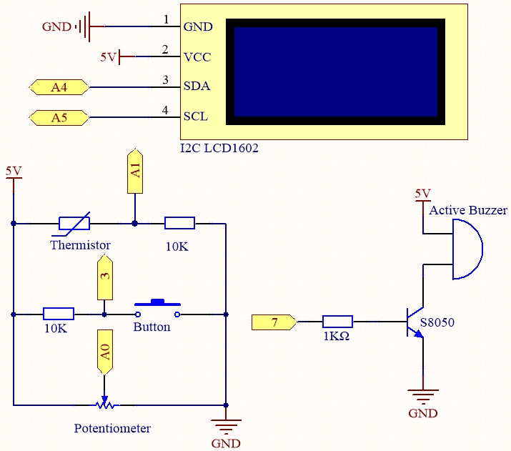

Schematic
../_images/wiring_high_tem.png
Wiring
../_images/6.3_high_tem_alarm_bb.png

After the code is successfully uploaded, The LCD1602 shows the temperature detected by the thermistor and the high temperature threshold value, which can be adjusted using a potentiometer. The threshold value is stored on EEPROM at the same time, so if the current temperature exceeds the threshold value, the buzzer will sound.
If the code and wiring are fine, but the LCD still does not display content, you can turn the potentiometer on the back.

  2. To set the high temperature threshold, the function upperTemSetting() is called when state is 1 (state switches between 0 and 1 with button press) in the main program, otherwise monitoringTemp() is called to display the current temperature and the set threshold.
    void loop()
        if (state == 1)
            upperTemSetting();
        else {
            monitoringTemp();
  3. About upperTemSetting() function.
    void upperTemSetting()
        int setTem = 0;
        lcd.clear();
        lcd.setCursor(0, 0);
        lcd.print("Adjusting...");
        lcd.setCursor(0, 1);
        lcd.print("Upper Tem: ");
        while (1) {
            lcd.setCursor(11, 1);
            setTem = map(analogRead(potPin), 0, 1023, 0, 100);
            lcd.print(setTem);
            if (state == 0)
                EEPROM.write(0, setTem);
                upperTem = setTem;
                lcd.clear();
                return;
    • A threshold can be set with this function. When you enter this function, the LCD1602 displays the current threshold value, which can be modified using the potentiometer. This threshold value will be stored in EEPROM and exited when the button is pressed again.
  4. About monitoringTemp() function.
    void monitoringTemp()
        long a = analogRead(temPin);
        float tempC = beta / (log((1025.0 * 10 / a - 10) / 10) + beta / 298.0) - 273.0;
        float tempF = 1.8 * tempC + 32.0;
        lcd.print("Temp: ");
        lcd.print(tempC);
        lcd.print(char(223));
        lcd.print("C   ");
        lcd.print("Upper: ");
        lcd.print(upperTem);
        lcd.print("C   ");
        delay(300);
        if (tempC >= upperTem)
            digitalWrite(buzzerPin, HIGH);
            delay(50);
            digitalWrite(buzzerPin, LOW);
            delay(10);
        else
    • Using this function, you can display temperature and set an alarm.
    • The thermistor value is read and then converted to Celsius temperature by the formula and displayed on the LCD1602.
    • The set threshold is also displayed on the LCD.
    • If the current temperature is greater than the threshold, the buzzer will sound an alarm.
