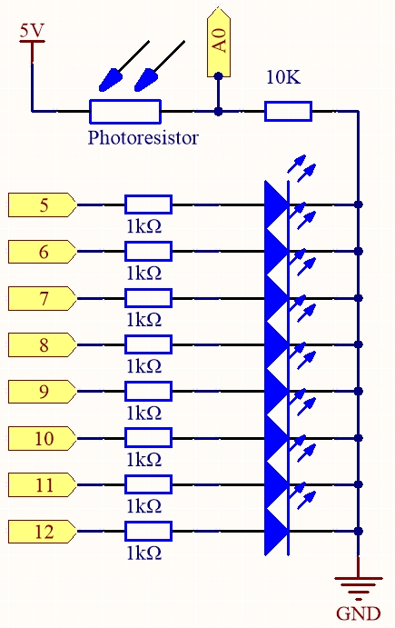

Schematic
../_images/circuit_6.1_light_led.png

  • Open the 6.1.light_control_led.ino file under the path of 3in1-kit\learning_project\6.1.light_control_led.
Now, shine some light on the photoresistor, and you will see several LEDs light up. Shine more light and you will see more LEDs light up. When you place it in a dark environment, all the LEDs will go out.

void loop()
    sensorValue = analogRead(photocellPin); //read the value of A0
    ledLevel = map(sensorValue, 300, 1023, 0, NbrLEDs); // map to the number of LEDs
    for (int led = 0; led < NbrLEDs; led++)//
        if (led < ledLevel ) //When led is smaller than ledLevel, run the following code.
            digitalWrite(ledPins[led], HIGH); // turn on pins less than the level
        else
            digitalWrite(ledPins[led],LOW); // turn off pins higher than
By using the map() function, you can map the photoresistor value to the 8 LEDs, for example, if sensorValue is 560, then ledLevel is 4, so at this point, ledPins[0] to ledPins[4] should be lit, and ledPins[5] to ledPins[7] should be off.
