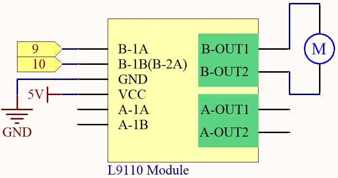

Schematic
../_images/circuit_1.3_wheel_l9110.png
Wiring
L9110S
R4 Board
Motor
VCC
5V
GND
GND
B-1B(B-2A)
9
B-1A
10
OA
one wire of the motor
OB
../_images/1.4_pumping_bb.png
