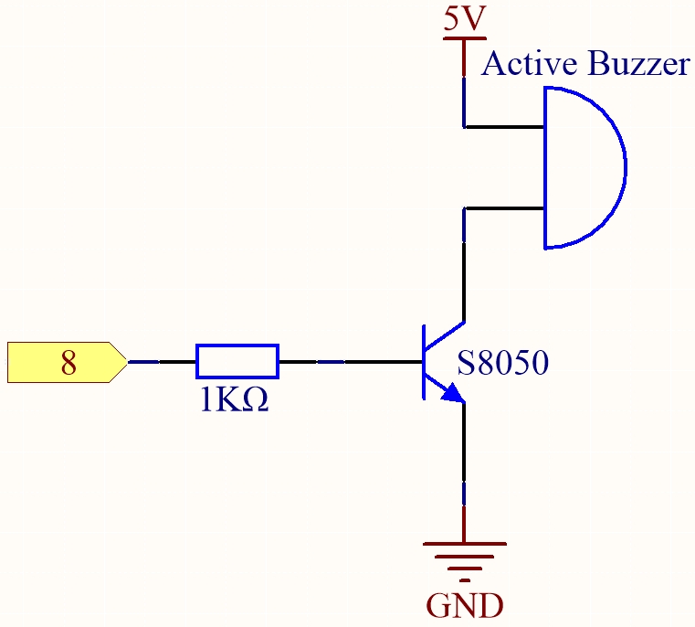

Schematic
../_images/circuit_1.2_beep.png
