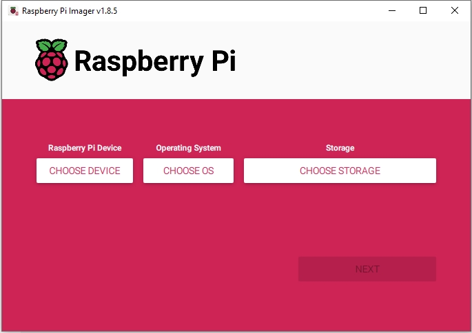

  3. Insert the Micro SD card into the computer or laptop’s SD card slot. If the computer or laptop only has a full-size port for SD cards, use a Micro SD card adapter.

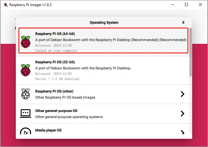

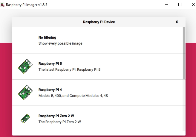

  4. In the Raspberry Pi Imager, click CHOOSE OS -> Raspberry Pi OS(Legacy).
    Warning
    • Please do not install the Bookworm version to avoid the double-click function and the virtual keyboard not working.
    • You need to install the Raspberry Pi OS (Legacy) version - Debian Bullseye.
    • Additionally, for a perfect touch experience, it is recommended to install the Ubuntu system.
    _images/3d33.png

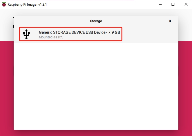

  5. Select the SD card you are using.

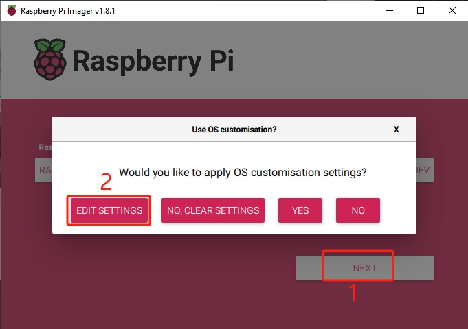

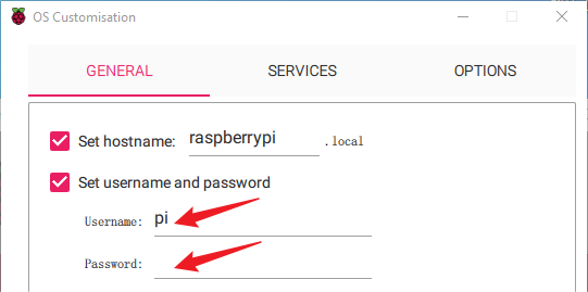

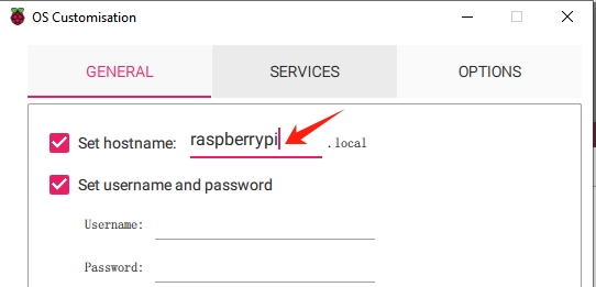

  6. To open the advanced options page, click the setting button (appears after selecting operating system) or press Ctrl+Shift+X. Now, set hostname, enable ssh and set the username and password.
    Warning
    Make sure to note down the hostname, username, and password; they’re crucial for later remote access to the Raspberry Pi.

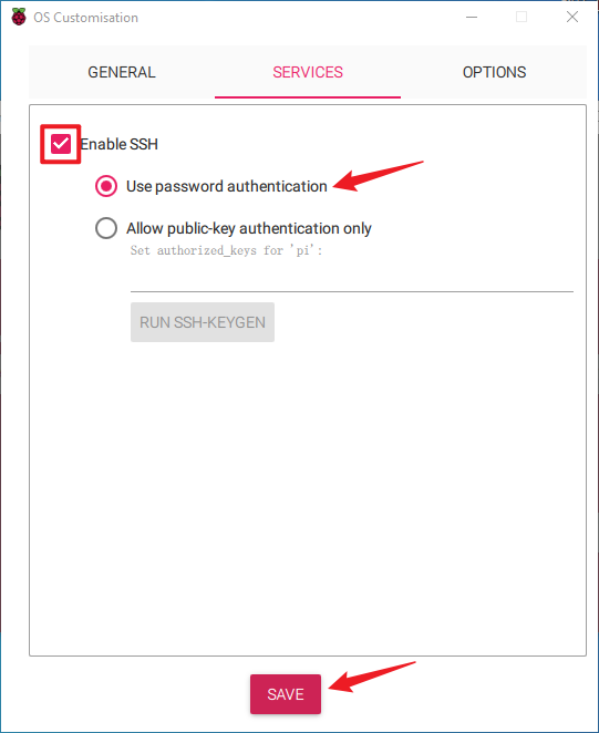

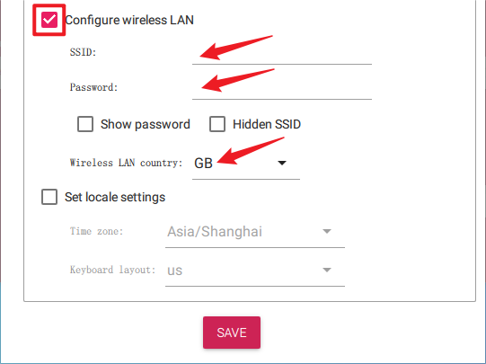

  7. Then scroll down to complete the wifi configuration and click SAVE.
    Note
    wifi country should be set the two-letter ISO/IEC alpha2 code for the country in which you are using your Raspberry Pi, please refer to the following link: https://en.wikipedia.org/wiki/ISO_3166-1_alpha-2#Officially_assigned_code_elements

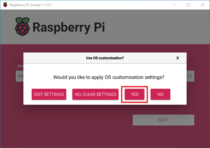

  8. Click the WRITE button.
    _images/3d7.png

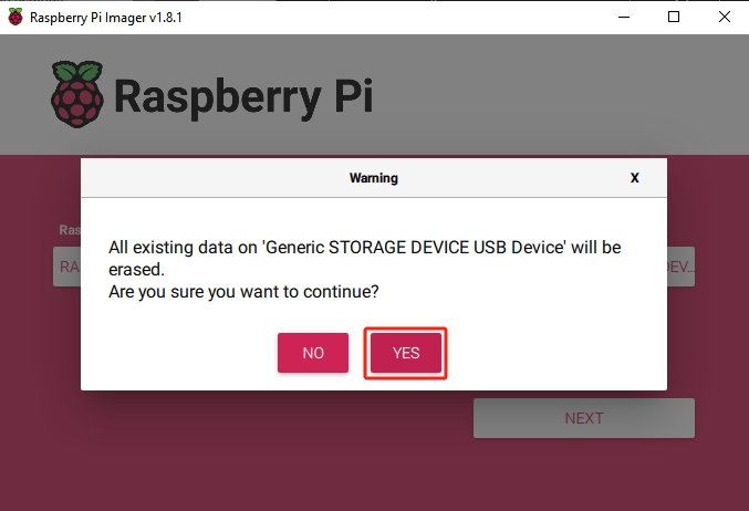

  9. The Imager will overwrite any files already on the SD card. If the SD card has any files, back up these files before clicking Yes.
    _images/3d8.png

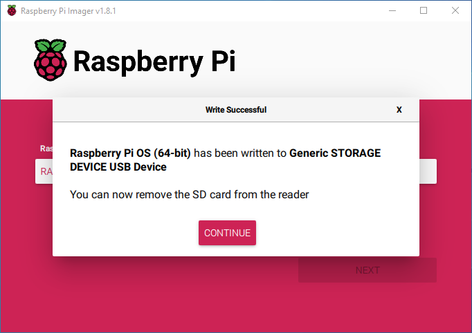

  10. After the Imager completes installing the Operating System on the SD card, click Continue to complete the installation.
    _images/3d9.png
