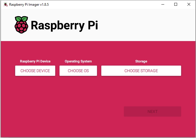

Raspberry Pi Imager is a quick and easy way to install the Raspberry Pi operating system to a Micro SD card from a computer or laptop.
Browse to the Raspberry Pi Imager site and download the version that matches the computer or laptop's operating system (www.raspberrypi.org/software). When the download is complete, launch the installer program and follow the prompts to install the Raspberry Pi Imager.

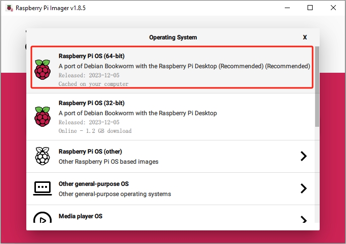

In the Raspberry Pi Imager, click CHOOSE OS -> Raspberry Pi OS(other).
_images/3d33.png
Scroll down to the end of the newly opened page and you will see Raspberry Pi OS(Legacy) and Raspberry Pi OS Lite(Legacy), these are security updates for Debian Buster, the difference between them is with or without the desktop. It is recommended to install Raspberry Pi OS(Legacy), the system with the desktop.
_images/3d34.png

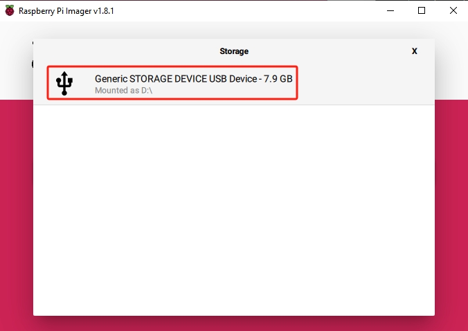

Select the SD card you are using.

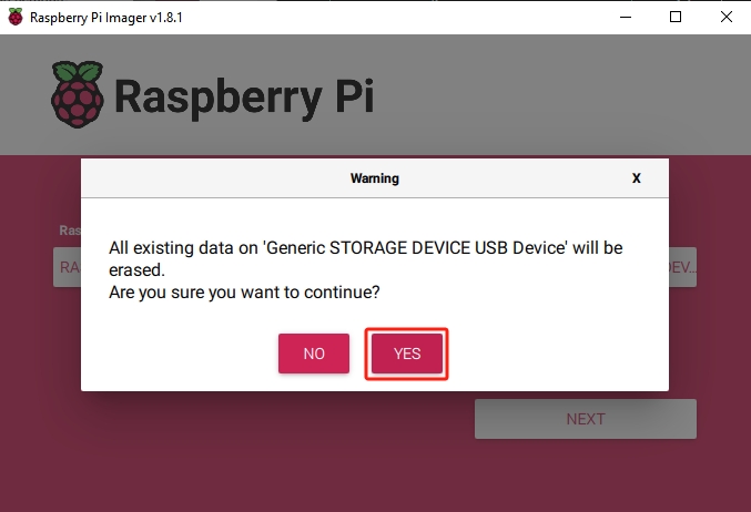

The Imager will overwrite any files already on the SD card. If the SD card has any files, back up these files before clicking Yes.
_images/3d8.png

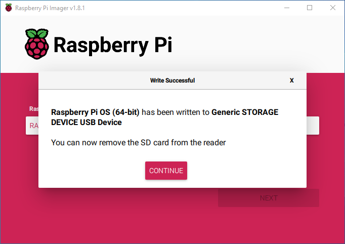

After the Imager completes installing the Operating System on the SD card, click Continue to complete the installation.
