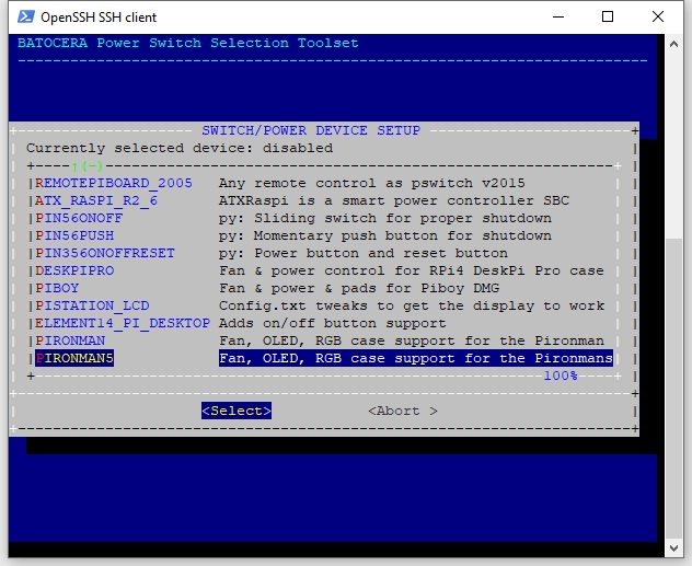

  4. Use the down arrow key to navigate to the end, select and activate the Pironman5 services.
    ../../_images/batocera_configure_pironman51.png

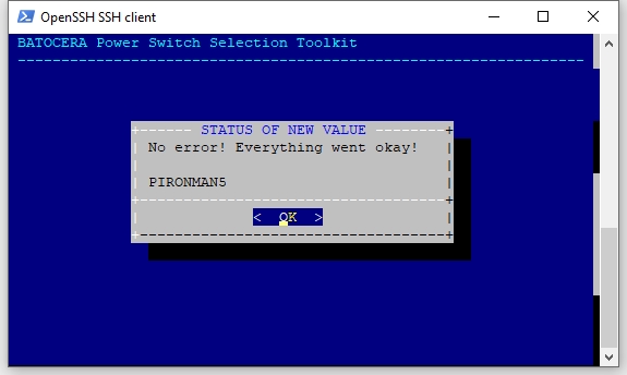

  5. After activating the pironman5 service, select OK.
    ../../_images/batocera_configure_pironman5_ok1.png
