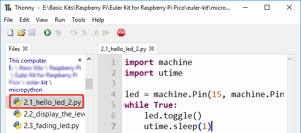

The code section in the projects tells you exactly which code is used, so double-click on the .py file with the serial number in the pico-2w-kit-main/micropython/ path to open it.
However, you must first download the package and upload the library, as described in 1.4 Upload the Libraries to Pico.
  1. Open code.
    For example, 2.1_hello_led.py.
    If you double click on it, a new window will open on the right. You can open more than one code at the same time.
    open_code

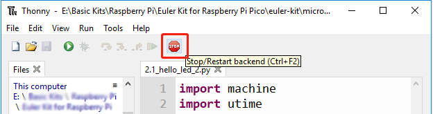

  4. Stop running
    stop_it
    To stop the running code, click the Stop/Restart backend button. The %RUN -c $EDITOR_CONTENT command will disappear after stopping.

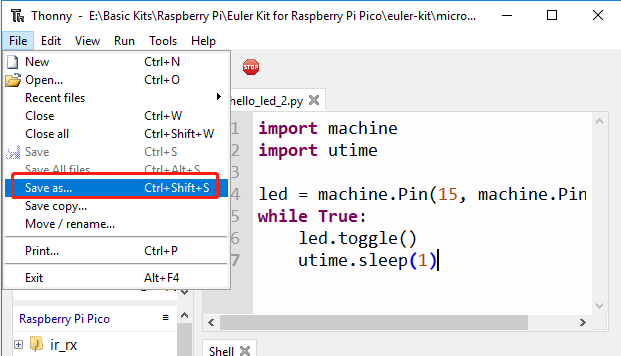

  5. Save or save as
    You can save changes made to the open example by pressing Ctrl+S or clicking the Save button on Thonny.

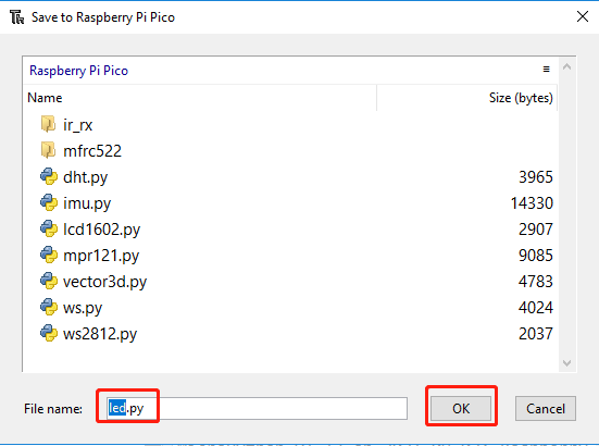

    The code can be saved as a separate file within the Raspberry Pi Pico 2 W by clicking on File -> Save As.
    save_as
    Select Raspberry Pi Pico.
    sec_pico
    Then click OK after entering the file name and extension .py. On the Raspberry Pi Pico 2 W drive, you will see your saved file.
    sec_name
    Regardless of what name you give your code, it’s best to describe what type of code it is, and not give it a meaningless name like abc.py. When you save the code as main.py, it will run automatically when the power is turned on.

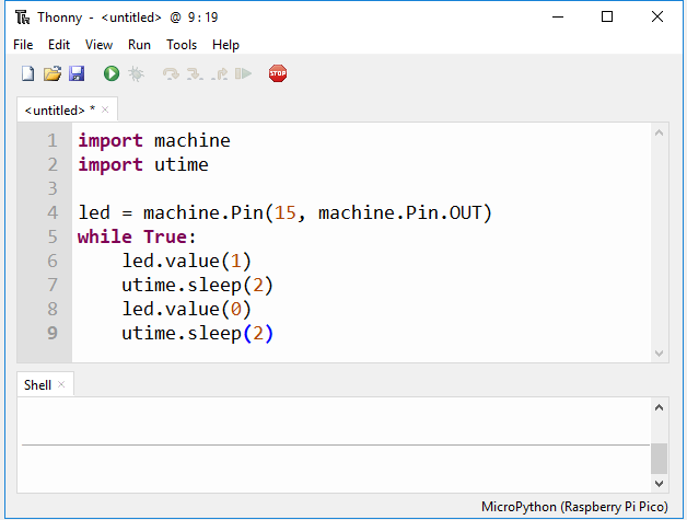

  1. Create a new file
    Open Thonny IDE, click New button to create a new blank file.
    new_file
  2. Copy code
    Copy the code from the project to the Thonny IDE.
    copy_file

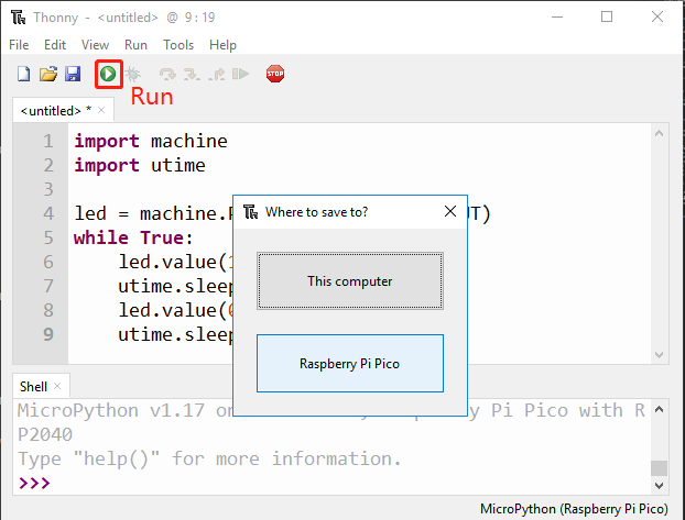

  4. Run and save the code
    You need click Run Current Script or simply press F5 to run it. If your code has not been saved, a window will pop up asking to save to This computer or Raspberry Pi Pico.
    where_save
