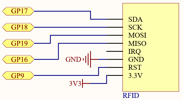

Schematic
sch_rfid

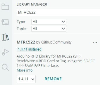

  • The MFRC522 library is used here, you can install it from the Library Manager.
    ../_images/lib_mfrc522.png

    • Check all wiring connections, especially the SPI lines (SCK, MOSI, MISO, SS).
    • Ensure the RFID module is receiving power (VCC and GND connections).
    • Verify that the correct GPIO pins are defined in the code.
