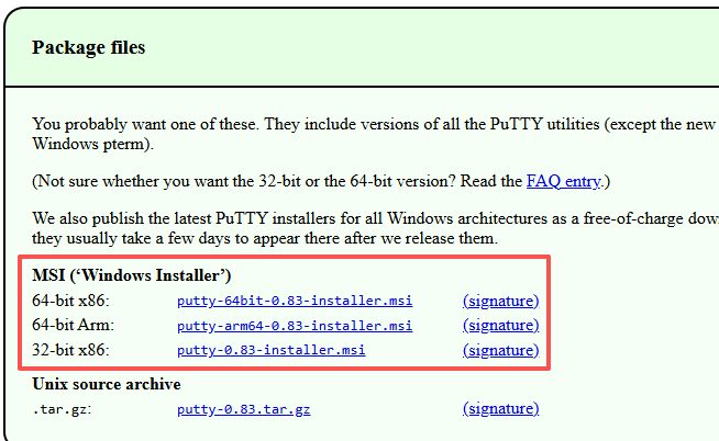

  1. Download PuTTY from PuTTY and install it on your computer.
    ../../_images/putty_download.png

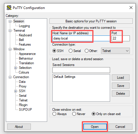

  2. Open PuTTY and prepare the connection:
    • Enter your Raspberry Pi’s hostname or IP address in Host Name.
    • Set the Port to 22.
    • Click Open to connect.
    ../../_images/putty_open.png

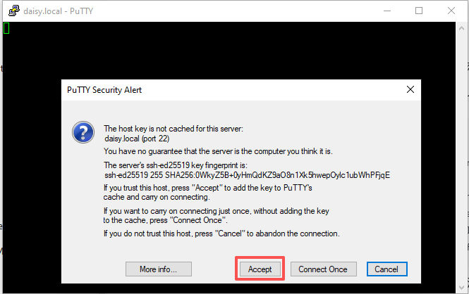

  3. If a security warning appears on first use, click Accept to continue.
    ../../_images/putty_accept.png

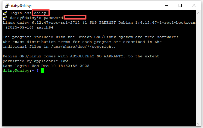

  4. Log in to the Raspberry Pi:
    • When you see login as:, enter the username you set in Raspberry Pi Imager.
    • Enter your password (it will not appear while typing—this is normal).
    • After logging in, the terminal is ready for you to enter commands and operate your Raspberry Pi remotely.
    ../../_images/putty_login.png
