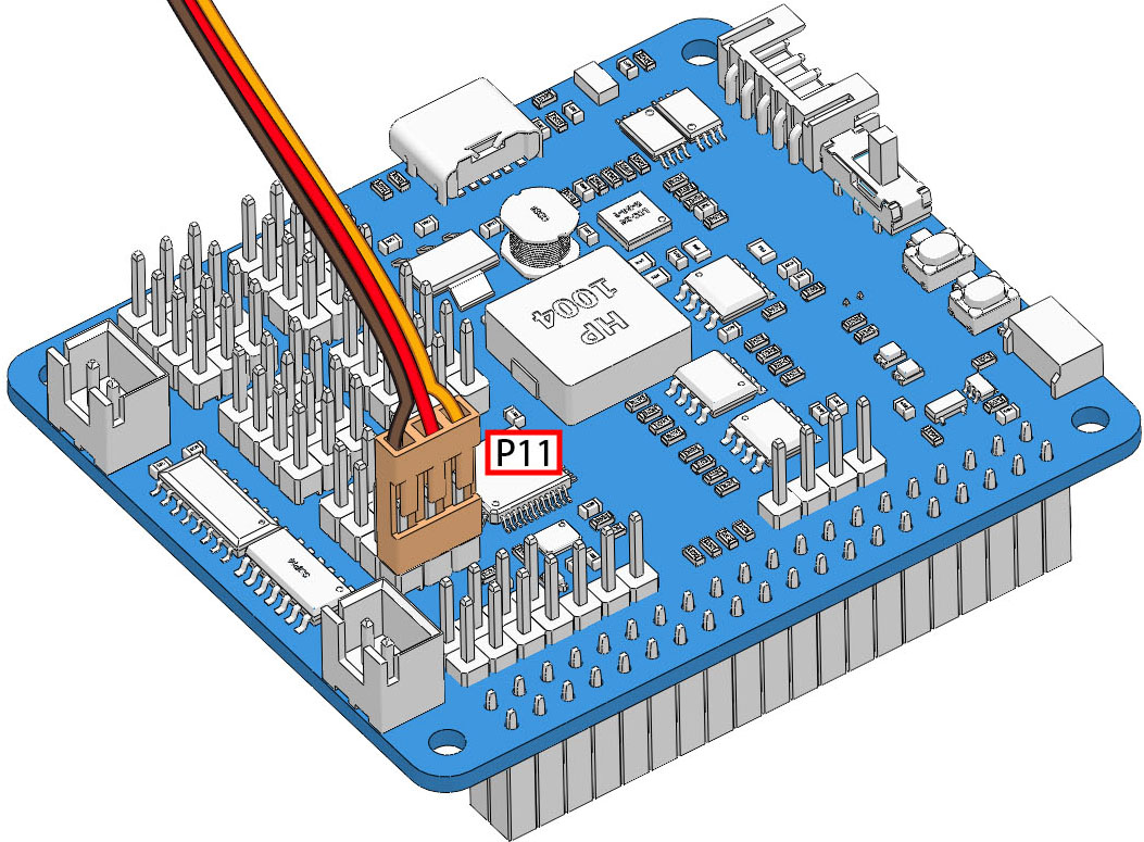

  3. Next, plug the servo cable into the P11 port as follows, at the same time you will see the servo arm rotate to a position(This is the 0° position, which is a random location and may not be vertical or parallel.).
    ../_images/servo_pin11.jpg
  4. Now, remove the servo arm, ensuring the servo wire remains connected, and do not turn off the power. Then continue the assembly following the paper instructions.
  • Do not unplug this servo cable before fixing it with the servo screw, you can unplug it after fixing it.
  • Do not rotate the servo while it is powered on to avoid damage; if the servo shaft is not inserted at the right angle, pull the servo out and reinsert it.
  • Before assembling each servo, you need to plug the servo cable into PWM pin and turn on the power to set its angle to 0°.
