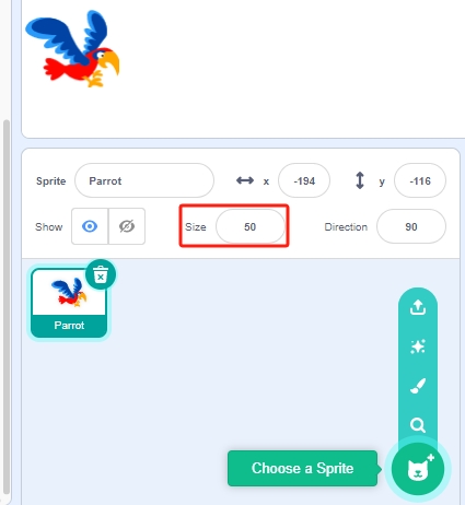

  • Delete the default sprite and use the Choose a Sprite button to add the Parrot sprite. Set its size to 50% and position it on the bottom left corner.

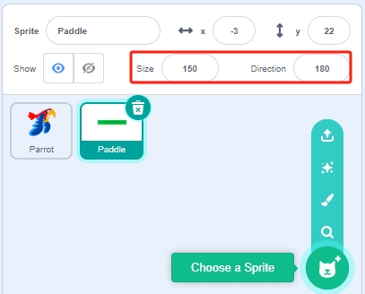

  • Add the Paddle sprite, set its size to 150%, rotate it to 180 degrees, and position it in the top right corner.

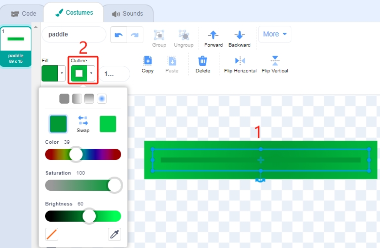

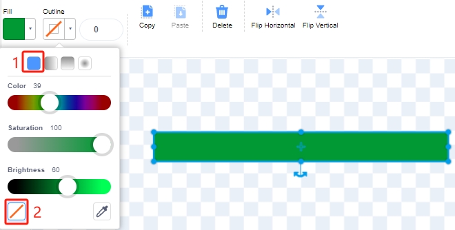

  • Navigate to the Costumes page of the Paddle sprite, select the Paddle on the canvas, and then click the Outline tool.
    ../../_images/parrot_set_parrot1.png
  • Change the outline effect to full fill mode and use the removal tool to eliminate it.
    ../../_images/parrot_set_parrot2.png

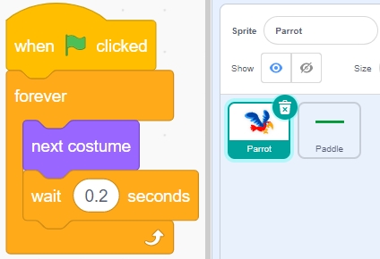

  • When the green flag is clicked, switch the costume every 0.2 seconds to maintain the appearance of flight.

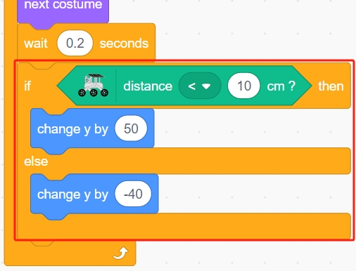

  • If the ultrasonic detection distance is less than 10cm, increase the y-coordinate by 50, causing the Parrot to ascend. Otherwise, decrease the y-coordinate by 40, causing the Parrot to descend.
    ../../_images/parrot_script_parrot3.png

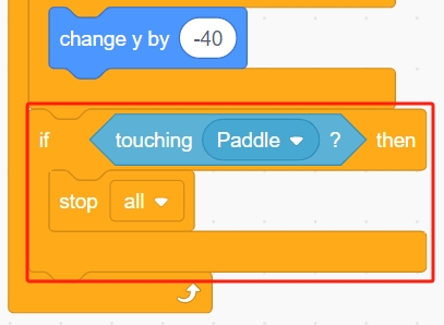

  • If the Parrot sprite makes contact with the Paddle sprite, the game ends, and the script ceases execution.

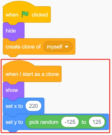

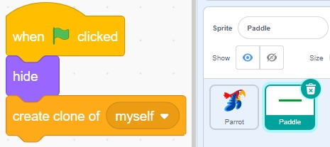

  • Hide the Paddle sprite when the green flag is clicked and simultaneously create a clone of itself. The [create clone of] block controls this cloning process.
    ../../_images/parrot_script_paddle1.png

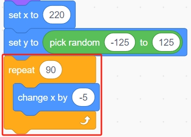

  • Set the clone’s position with the x-coordinate at 220 (rightmost) and the y-coordinate randomly between (-125 to 125).
    ../../_images/parrot_script_paddle2.png
  • Use the [repeat] block to gradually decrease its x-coordinate, making the clone move slowly from right to left until it disappears.
    ../../_images/parrot_script_paddle3.png

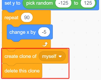

  • Re-clone a new Paddle sprite and delete the previous clone.
    ../../_images/parrot_script_paddle4.png
