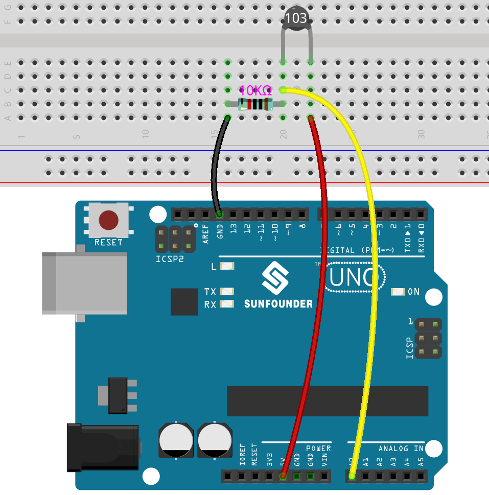

Wiring
  • The thermistor is black or green and marked 103.
../_images/thermistor_bb.png
  • You can open the file 4.5_thermometer.ino under the path of euler-kit/arduino/4.5_thermometer.
  • Or upload the code through the Arduino Web Editor.
Don’t forget to select the Raspberry Pi Pico board and the correct port before clicking the Upload button.
After the code is successfully uploaded, the Serial Monitor will print out the Celsius and Fahrenheit temperatures.
