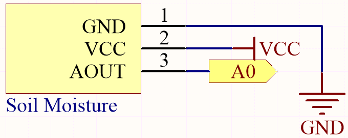

Schematic
../_images/circuit_5.4_soil.png
