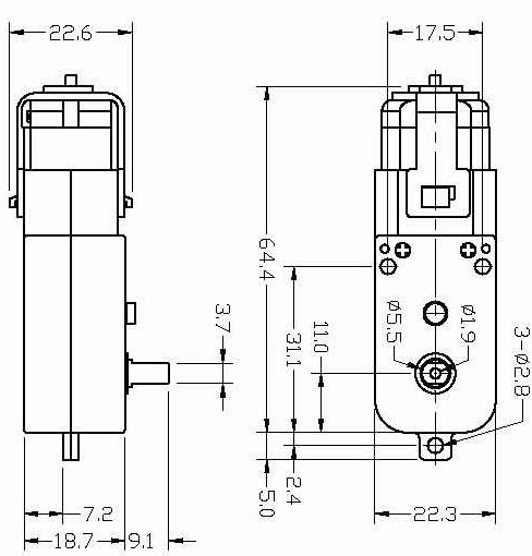

Body Dimensions: 70 x 22 x 18mm
Wires Length: 200mm & 28 AWG
Weight: 30.6g
Dimensional Drawing
