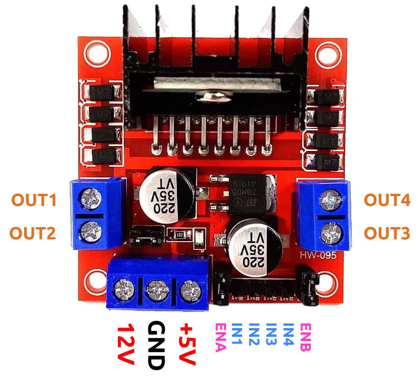

This L298N Motor Driver Module is a high power motor driver module for driving DC and Stepper Motors. This module consists of an L298 motor driver IC and a 78M05 5V regulator. L298N Module can control up to 4 DC motors, or 2 DC motors with directional and speed control.
../_images/l298n_pin.jpg
  • IN1 & IN2: Motor A input pins. Used to control the spinning direction of Motor A
  • IN3 & IN4: Motor B input pins. Used to control the spinning direction of Motor B
  • ENA: Enables PWM signal for Motor A. Here it has been connected to 5V with a jumper cap.
  • ENB: Enables PWM signal for Motor B. Here it has been connected to 5V with a jumper cap.
  • OUT1 & OUT2: Output pins of Motor A
  • OUT3 & OUT4: Output pins of Motor B
  • 12V: 12V input from DC power Source
  • 5V: Supplies power for the switching logic circuitry inside L298N IC
  • GND: Ground pin

About 5V Enable Cap
The L298N Motor Driver module consists of an L298 Motor Driver IC, 78M05 Voltage Regulator, resistors, capacitor, Power LED, 5V jumper in an integrated circuit.
../_images/l298n_introduce.jpg
78M05 Voltage regulator will be enabled only when the jumper is placed. When the power supply is less than or equal to 12V, then the internal circuitry will be powered by the voltage regulator and the 5V pin can be used as an output pin to power the microcontroller.
The jumper should not be placed when the power supply is greater than 12V and separate 5V should be given through 5V terminal to power the internal circuitry.
