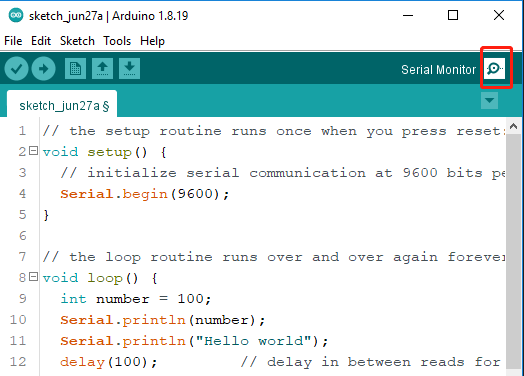

  1. Open the Arduino IDE, and paste the following code in it.
    // the setup routine runs once when you press reset:
    void setup() {
        // initialize serial communication at 9600 bits per second:
        Serial.begin(9600);
    // the loop routine runs over and over again forever:
    void loop() {
        int number = 100;
        Serial.println(number);
        Serial.println("Hello world");
        delay(100);         // delay in between reads for stability
    • Serial.begin(): Sets the data rate in bits per second (baud) for serial data transmission, here set to 9600.
    • Serial.println(): Prints data to the serial port as human-readable ASCII text followed by a carriage return character (ASCII 13, or ‘r’) and a newline character (ASCII 10, or ‘n’). This command takes the same forms as Serial.print().
  2. Select the correct board and port to upload the code.
  3. In the toolbar, click the magnifying glass icon to turn on Serial Monitor.
../_images/serial1.png

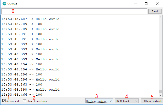

  1. Here is the Serial Monitor.
../_images/serial2.png
  • 1: Option to select between automatically scroll and not scroll.
  • 2: Option to show timestamp prior to data displayed on Serial Monitor.
  • 3: Ending selection, select the ending characters appended to data sent to Arduino. Selection includes:
    • No line Ending just sends what you type;
    • Newline is \n and will sends an ASCII new line code after what you typeï¼›
    • Carriage Return is \r, which will send an ASCII carriage return character after what you type;
    • Both NL & CR is \r\n which will send both a carriage return and a new line character after what you type.
  • 4: Select communication speed between Arduino board and PC. This value MUST be the same as the value set in Serial.begin().
  • 5: Clear all text on the output console.
  • 6: A textbox to send characters to the Arduino board, see 5.12 Serial Read for a tutorial.
