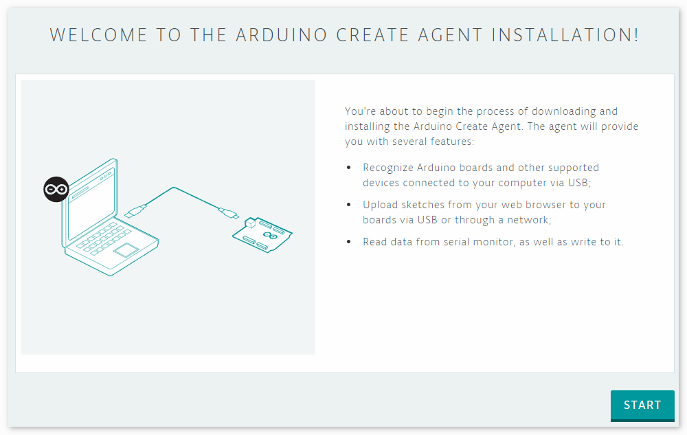

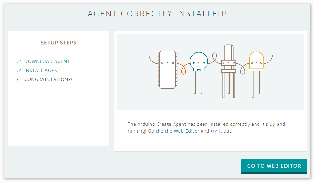

Install Arduino Create Agent
  1. Visit the address https://create.arduino.cc/getting-started/plugin/welcome.
  2. Click START.

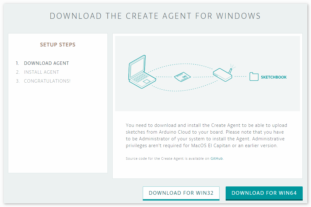

  1. Choose the version that suits your computer, and it will download an installation package.
  1. Install the agent.

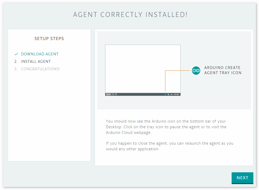

  1. After installation, go back to your browser, and you will see the following interface.
  1. Click NEXT, and then you can GO TO the web editor.

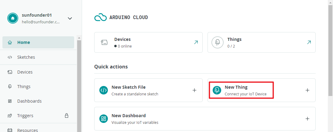

  2. Create a new thing.
    ../../_images/02_iot_cloud_3.png

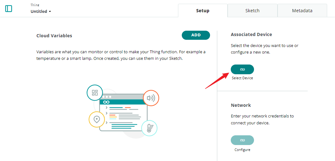

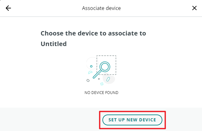

  3. Associate your device.
    ../../_images/02_iot_cloud_4.png

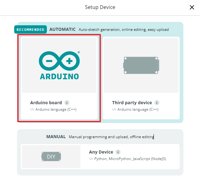

  4. Set up a new device.
    ../../_images/02_iot_cloud_5.png
  5. Choose your Arduino board.

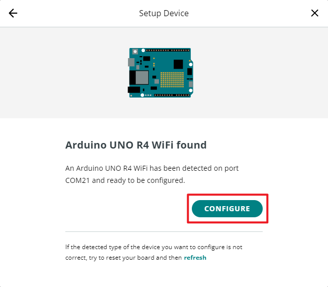

  6. Wait for a moment, and your UNO R4 WiFi will be detected. Continue by clicking configure.
    ../../_images/02_iot_cloud_7.png

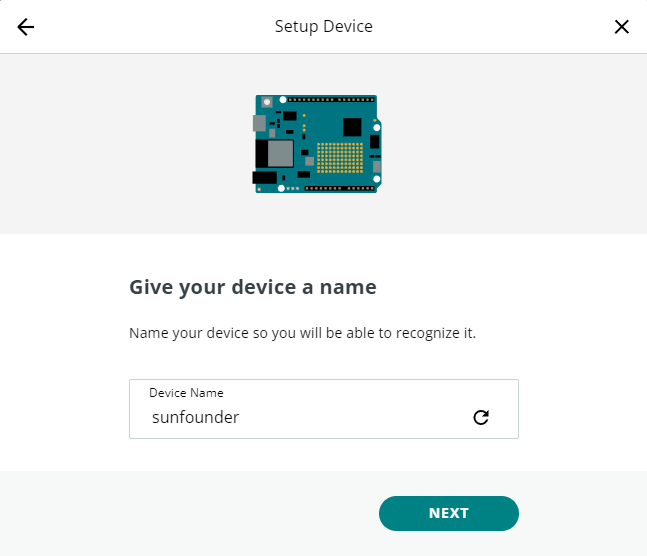

  7. Give your device a name.
../../_images/02_iot_cloud_8.png

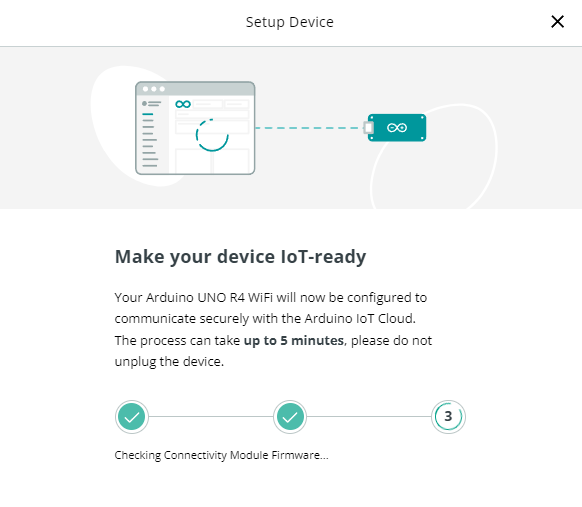

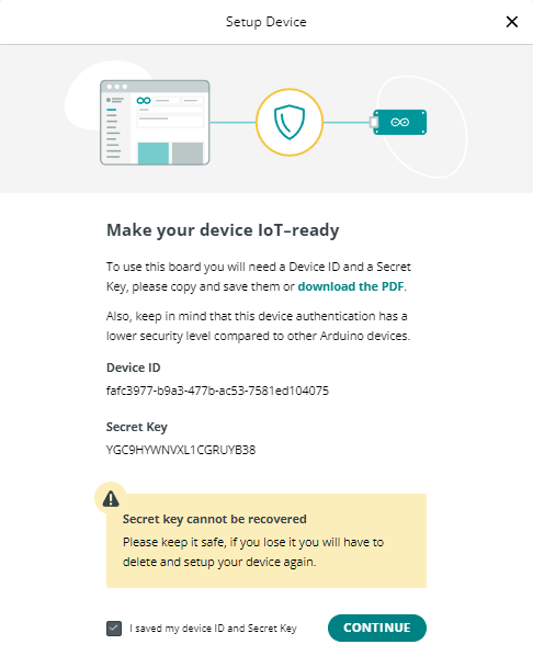

  1. Make your device IoT-ready, and remember to save the secret key.
../../_images/02_iot_cloud_9.png

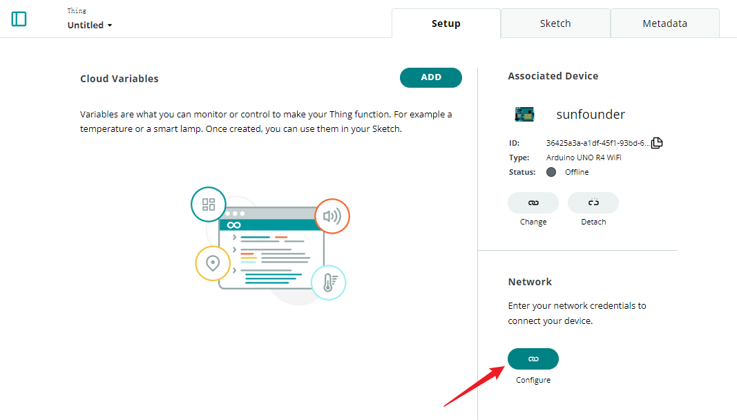

  1. Configure WiFi.
../../_images/02_iot_cloud_11.png
  1. Here you will need to enter your WiFi password and secret key.
../../_images/02_iot_cloud_12.png

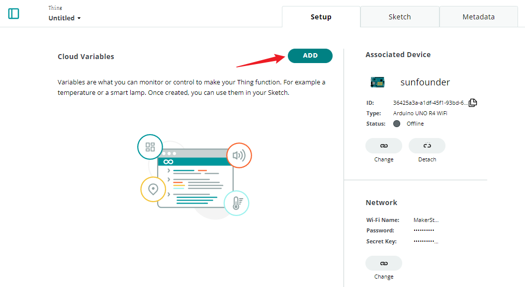

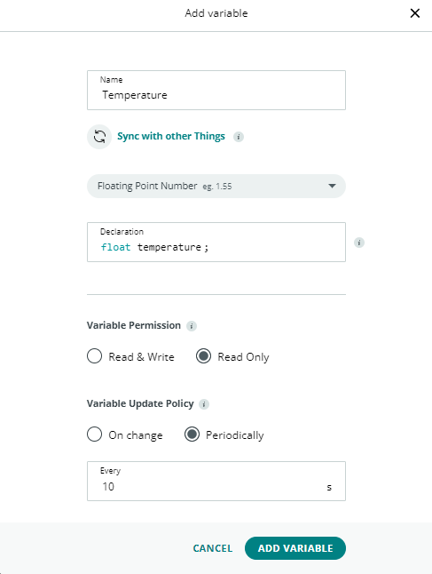

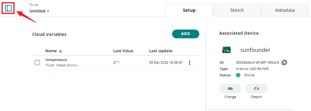

  1. Add a variable.
../../_images/02_iot_cloud_13.png
  1. Here, we want to display the temperature in IoT Cloud, so we configure a read-only float variable.
../../_images/02_iot_cloud_14.png

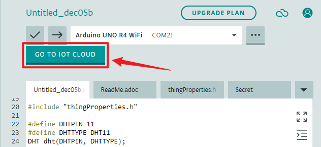

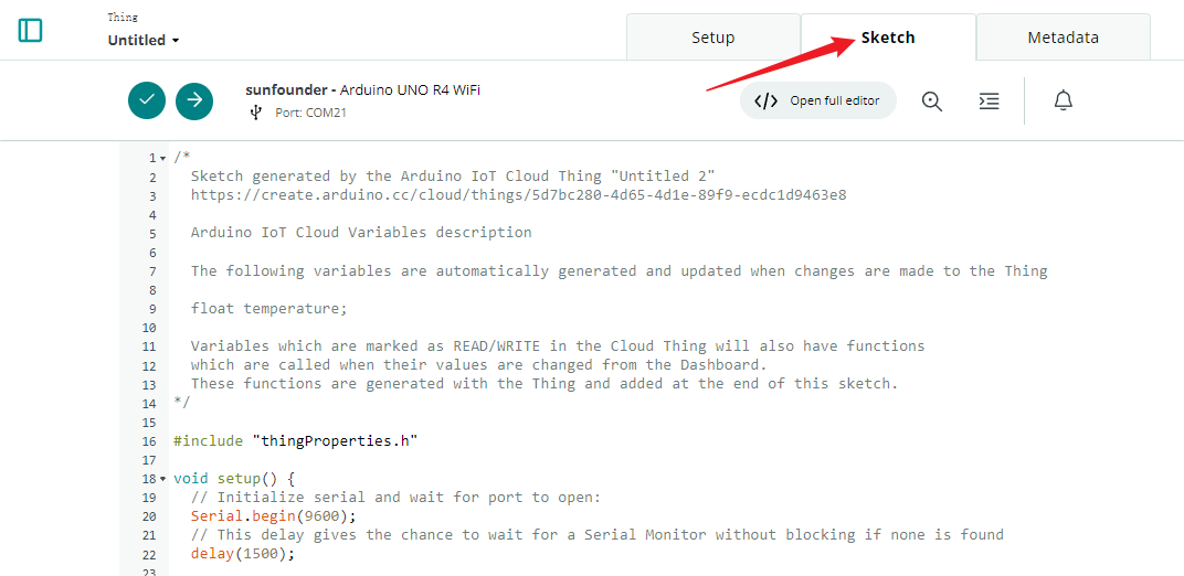

  1. After completion, go to the sketch.
../../_images/02_iot_cloud_15.png

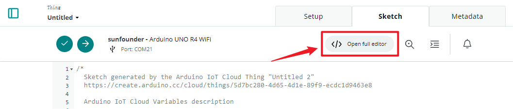

  1. Open the full editor.
../../_images/02_iot_cloud_16.png

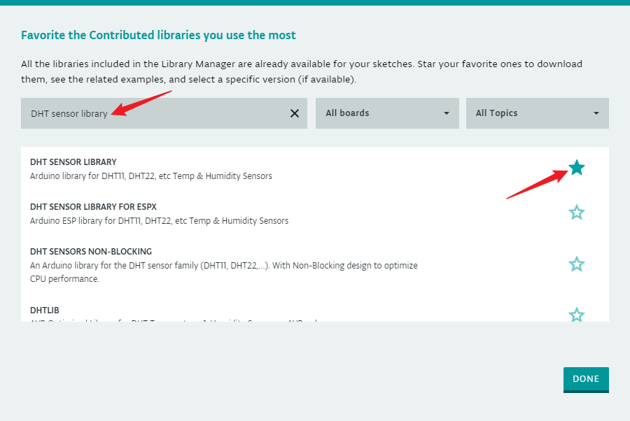

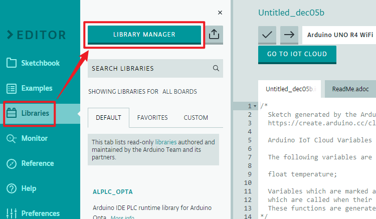

  1. Click on Libraries on the right side, then Library Manager.
../../_images/02_iot_cloud_17.png
  1. Search for the DHT sensor library and check it.

  1. Now, we need to edit the code. You can see that the editor has already prepared the IoT Cloud-related code for you. You just need to add the specific functionality you need. In this example, we added code to read the temperature using the DHT11 sensor.

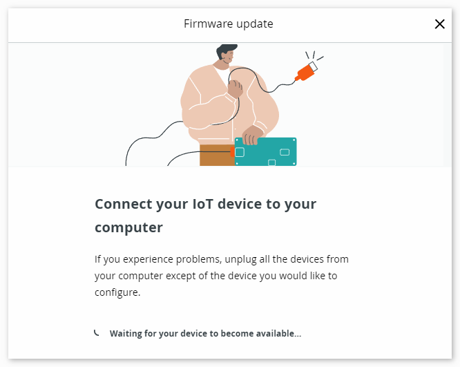

  1. Upload the code. You may be prompted to update; follow the prompts to complete.
../../_images/02_iot_cloud_20.png

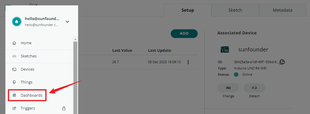

  1. Click on the menu in the top left corner.
../../_images/02_iot_cloud_22.png
  1. Click on the dashboard.
../../_images/02_iot_cloud_23.png

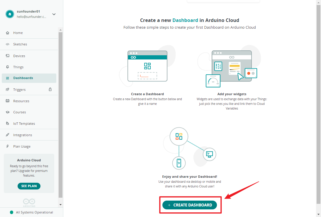

  1. Create dashboard.

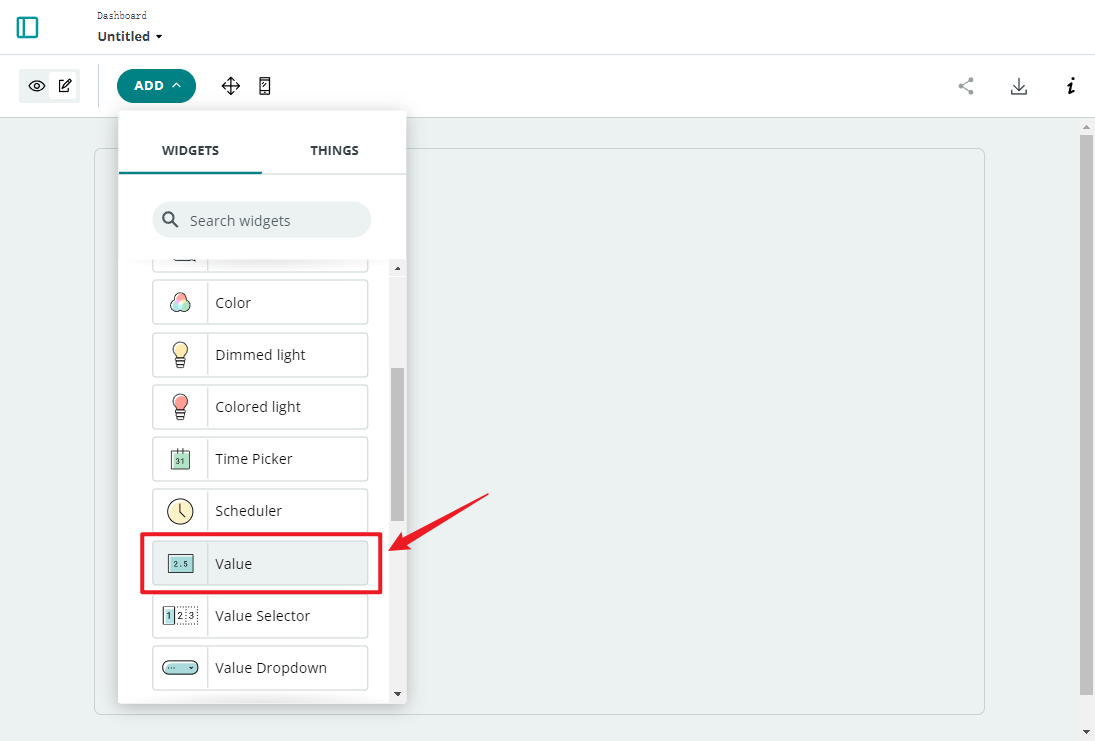

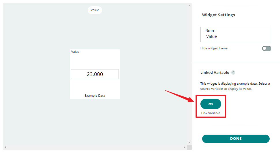

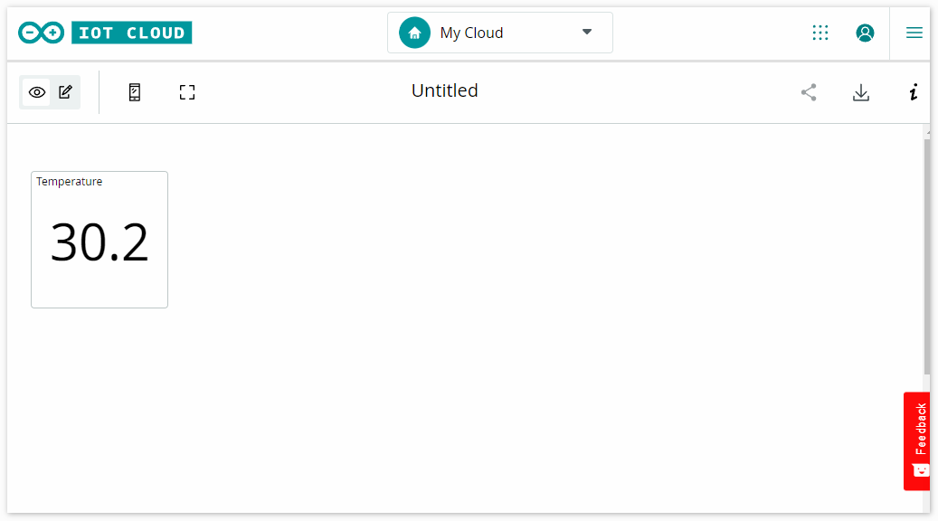

  1. There are many widgets available; here, we choose a value widget for displaying the temperature.
../../_images/02_iot_cloud_25.png
  1. After clicking, a widget settings interface will appear, where you can connect the widget to the cloud variable you created earlier.
../../_images/02_iot_cloud_26.png
  1. Now, you can view the sensor readings on Arduino IoT Cloud.
../../_images/02_iot_cloud_27.png
