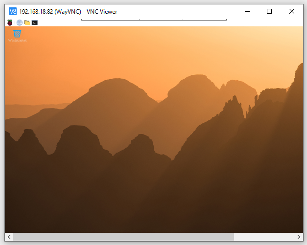

  4. You should now see the Raspberry Pi desktop:
    ../../_images/ssh_vnc_desktop.png
This completes the VNC setup process.
