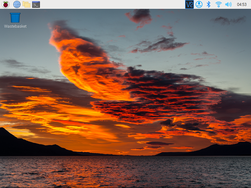

Login to VNC
You need to download and install the VNC Viewer on personal computer.
Open it once the installation is complete. Then, enter the host name or IP address and press Enter.
After entering your Raspberry Pi name and password, click OK.
Now you can see the desktop of the Raspberry Pi.
