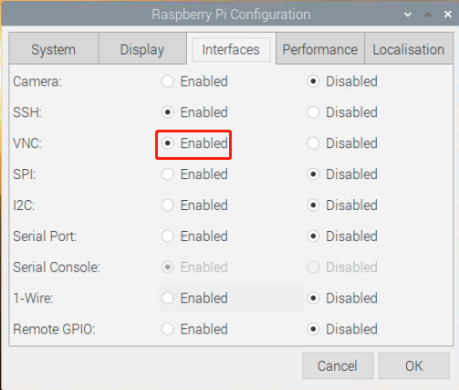

Connect a monitor (or TV), mouse and keyboard to the Raspberry Pi and power it on. Select the menu according to the numbers in the figure.
The following screen will be displayed. Set VNC to Enabled on the Interfaces tab, and click OK.
A VNC icon appears on the upper right of the screen and the VNC server starts.

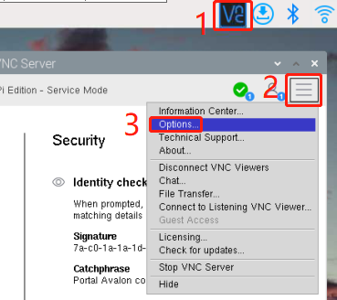

Open the VNC server window by clicking on the VNC icon, then click on the Menu button in the top right corner and select Options.
You will be presented with the following screen where you can change the options.
Set Encryption to Prefer off and Authentication to VNC password.
When you click the OK button, the password input screen is displayed. You can use the same password as the Raspberry pi password or a different password, so enter it and click OK.

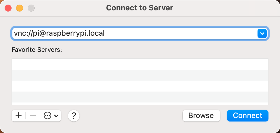

Now, select Connect to Server from the Finder’s menu, which you can open by right-clicking.
Type in
vnc://<username>@<hostname>.local(orvnc://<username>@<IP address>). After entering, click Connect.

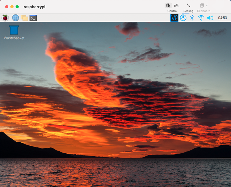

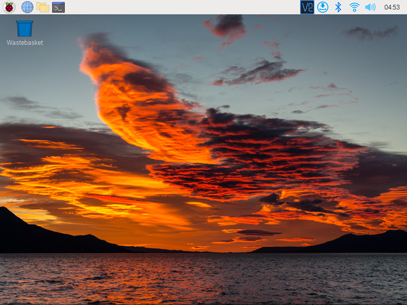

You will be asked for a password, so please enter it.
The desktop of the Raspberry pi will be displayed, and you will be able to operate it from the Mac as it is.
Type in
