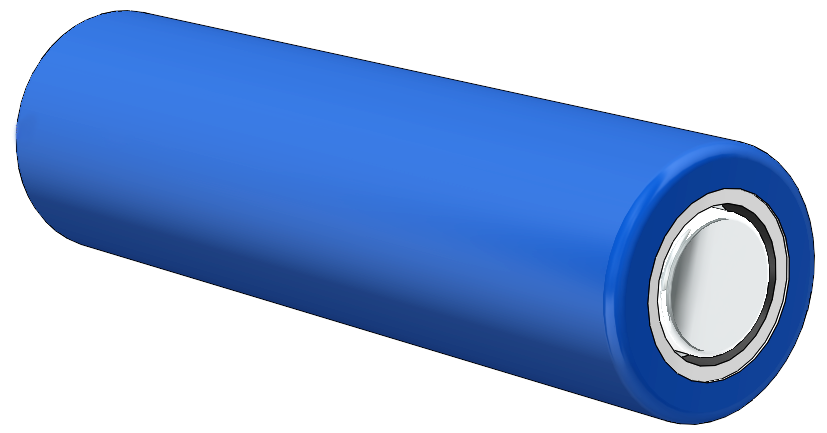

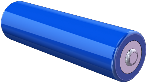

Button Top vs Flat Top?
Please choose battery with button top to ensure a good connection between the battery and the battery holder.
Button Top
Flat Top
../_images/battery.png ../_images/18650.PNG
