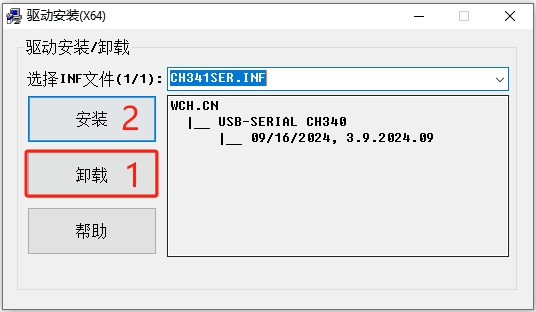

Double-click the
.exefile. If you downloaded the.zipversion, extract it first and then double-click the.exeinside.Click “Uninstall” first to remove any previous drivers, then click “Install”.

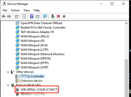

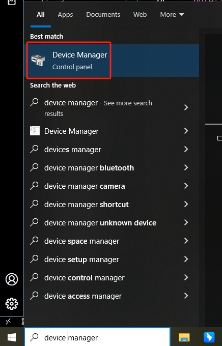

After installation, open Device Manager. You can click the Start or ⊞ (Windows) button and type “device manager” to quickly search for it.
In Device Manager, expand the “Ports (COM & LPT)” section. You should see USB-SERIAL CH340 (COM##) listed. The COM port number may vary.

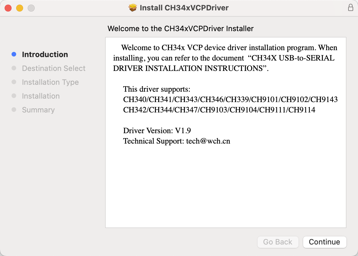

Open the extracted folder and double-click the
.pkgfile. Follow the prompts to install.Note
If you see a “System Extension Blocked” or “Unverified Developer” message, go to System Settings > Privacy & Security and click Allow next to the blocked extension. You may need to unlock with your password. Restart your Mac to finish installation.

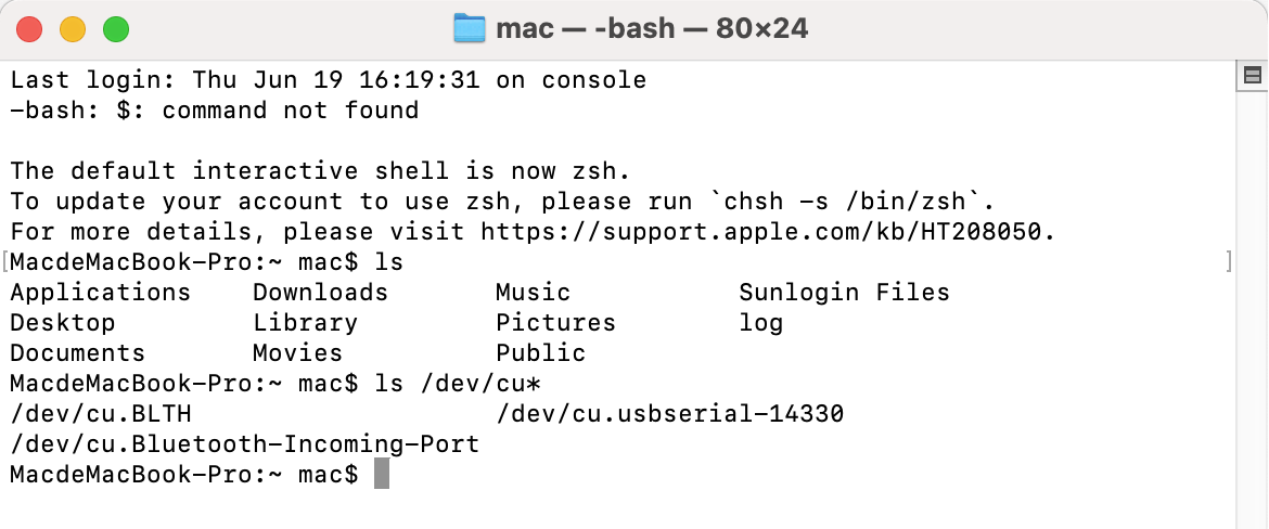

To verify the driver is working, plug in the CH340 device and open a Terminal window. Then run:
ls /dev/cu*
You should see a device like
/dev/cu.usbserial*****. The exact port name may vary.

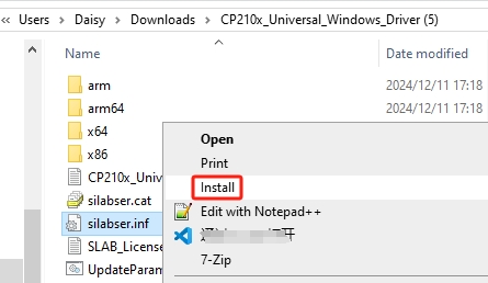

Extract the ZIP file, then right-click on the
.inffile and select Install. Follow any on-screen prompts to complete the driver installation.

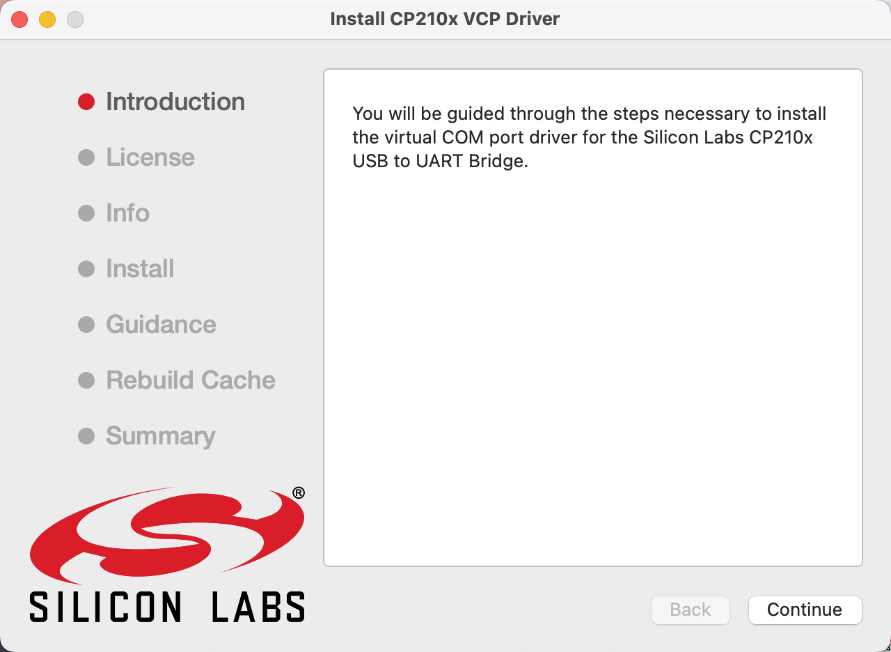

Extract the downloaded ZIP file, then double-click the included
.dmgfile to mount it.In the mounted volume, open and run Install CP210x VCP Driver.app.
Follow the on-screen instructions to complete the installation.
