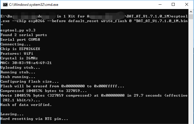

    3. Double click install_r3.bat to start the firmware burning. If you see the following prompt, the firmware has been installed successfully.
      ../_images/install_firmware.png

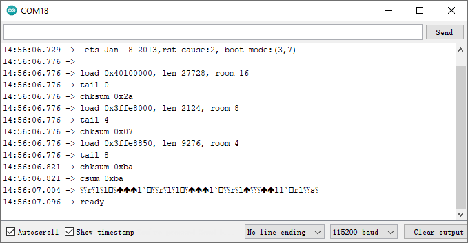

  2. You will be able to see information about the ESP8266 module if you click the magnifying glass icon(Serial Monitor) in the upper right corner and set the baud rate to 115200.
    ../_images/sp20220524113020.png
    • If ready doesn’t appear, you can try to reset the ESP8266 module(connect RST to GND) and re-open the Serial Monitor.
