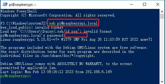

Now restart PowerShell and continue to run it as administrator. At this point you will be able to log in to your Raspberry Pi using the
sshcommand, where you will be prompted to enter the password you set up earlier.
